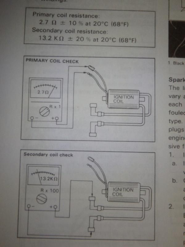

  19. andrewc
    andrewc Member
    49
    guelph ontario canada
    Just a longshot but is your meter set on too high of a setting?
    2.7 ohms is a very low resistance. Just make sure your meter is not on k or M ohms
  20. quebecois59
    Here is the way to test both primary and secondary resistances of the coils:
  21. Polock
    Rob, like Andrew said, lowest range on the meter. then touch the leads together, tight, note the reading. now the coils. clip the leads on, make a good connection and set them down. take your reading without touching them. now subtract the leads only reading from the coil reading and you have it.
    if you have a good spark, chances are the coils are good.
  22. big_rob420
    big_rob420 Member
    97
    cameron, NC
    alright thanks guys and thank you quebecois5 for the pic. the CD Manual does not show any pictures on how to perform tests it just shows the specs, so i was a little left in the dark on how to check it. but i will check my voltmeter and re check the coils first thing tomorrow as well as a compression check.
  23. wizard
    Be careful testing with the caps on, can give some strange results.
  24. quebecois59
    Actually, it could be interesting to test with the spark plug caps on and then without the caps, specially if the readings are strange with the caps on.
    Make sure the caps are screwed tight in before you perform the test.

    alright guys did a check with the old gauge didn't have time to run to the store and pick up a new gauge but i added a little oil to each cylinder and all 4 of them jumped up to about 90psi. i did the suggested check on the coils and got some pretty weird readings the ohms from the coils checked out just about perfect anywhere from 2.5 to 2.8 right on spec. but from the plugs it was 25 and 18 way out i think there may be something wrong with the plugs or the wires maybe.
  26. quebecois59
    If your spark plug caps are loose, it could be enough to make the resistance higher than normal. Of course if they are corroded inside, that could lead to higher resistance too. SOmtimes you just need to cut 1/4 inch off of the wire to have better grip for the cap screw.
    40 PSI more on a wet compression test compared to your first readings is a huge difference. It tends to confirm that you piston rings are bad. But 90 PSI is still pretty low. It is possible your valves don't close properly.
