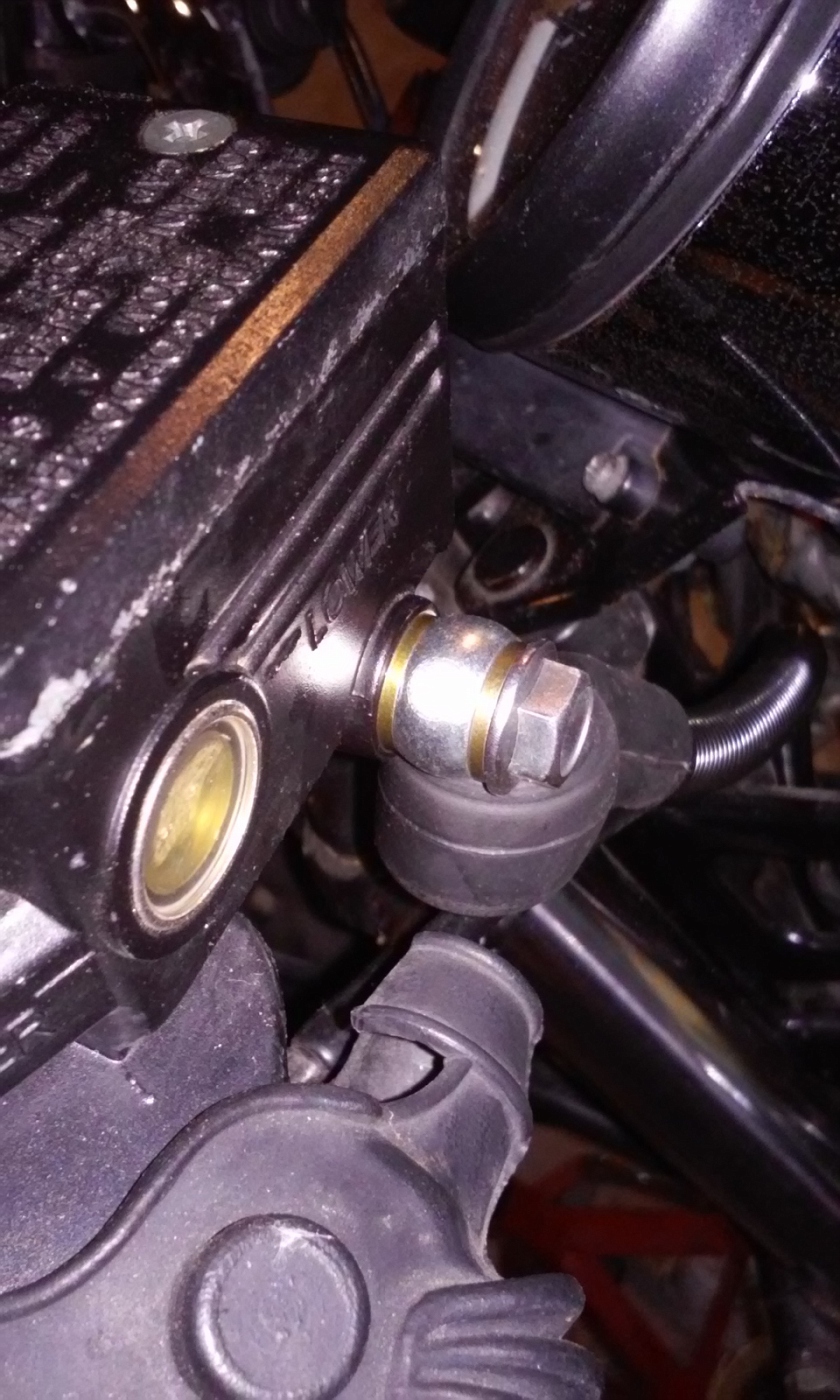

    here you can see the thicker than normal washers:

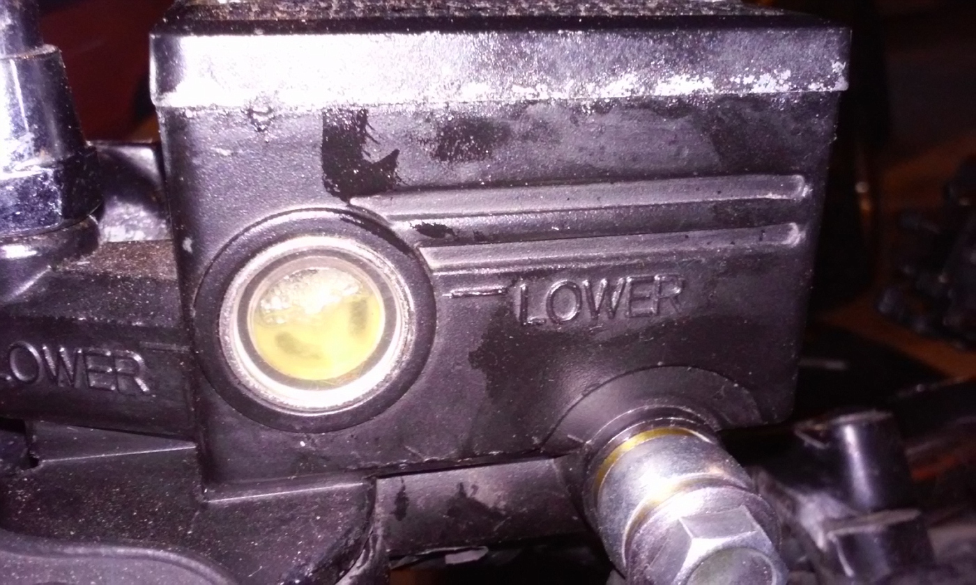

    here is the master cylinder box.
    [​IMG] [​IMG]
    The hoses came from xj4ever, they seem fine, as long as I use the original washers. I see no Yamaha on the master cylinder anywhere. So maybe it is an aftermarket.

    The bolt could be too long (for that m/c), you can always double-up on the crush washers (one or both sides) to allow the bolt to be torqued to its proper value of 19 foot-pounds of torque (max).

    I don't think that's the right color for the bolt.... Maybe that's the wrong part----

    Seems to be the same as all the others, should the MC bolt be different?
    They all seem to clean up really well, seems like they are all stainless.

    the washers look like brass, not copper, they should be the color of a penny.
    cut loose get the right stuff

    The right stuff ? And what would that be, these are plastic lined washers, thicker than a standard copper washer used on the banjo bolts. The standard washers won't work unless I use more then one on each side. Not sure that would be better than what I have. These are the original spacers, apparently that came with this, possibly aftermarket MC. So what would the right replacement be?

    This must be an aftermarket MC, it all worked fine before replacing the hose, so I assume it was the correct bolt and washers for that setup. I guess we'll see when it all gets tested after everything is back together.

    I see a sight window on the bolt side . I do not think it is an oem part.
    Bolt, Union 90401-10034-00 or 90401-10159-00
    I measured a few from a 550 which is supposed to be the same part. 20.76 mm 20.88 mm 21 mm 21 mm.
    the shorter ones were a tinted finish and the long ones were silver color
    if the mc and washers are working for you that is fine. it will be when you rebuild it you will have to find correct parts for an unknown brand.
