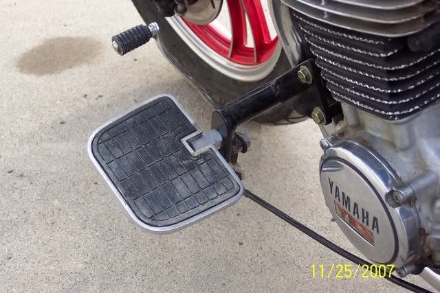

    PainterD, can you send some close-up photos of the forwatd controls you made? MAybe I can work something like that out easier than modding to use the Maxim controls.
    Dave

    OK, I used soem parts off of an old Maxim I have here. Mainly all I did was used 1/4" flat stock to make two mounting brackets comomg off the front motor mounts, just behind the headers. Then I mounted the pegs (mini-floorboards now) on the brackets. Then I mounted the shifter and brake peddles on pivots below the pegs and ran the control arms back from there. I used 3/8" round stock for the brake rod and 1/4" round stock for the shifter rod. I had to thread the ends enough so I could adjust the peddles once I got everything together.
    Here's some photos I took a while back. Not the best, but you will get an idea just how it's done:
