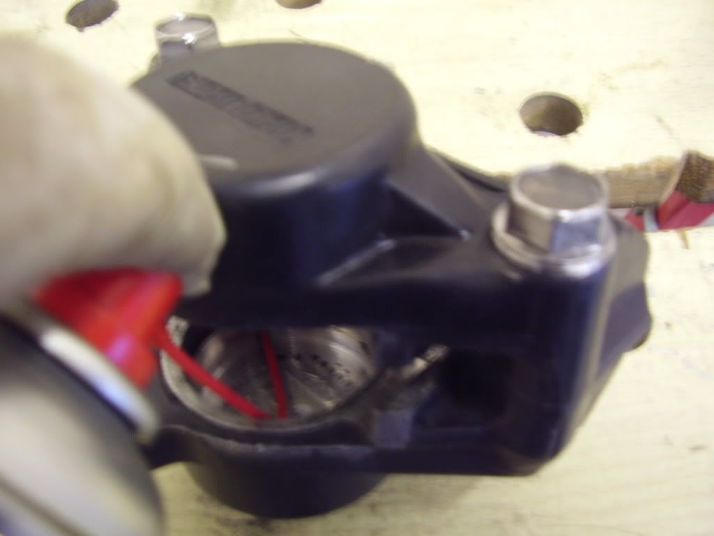

  16. maximike
    maximike Member
    536
    Portland, OR, USA
    I think you are referring to the sliding pins that the caliper travels on when you say "piston" The actual piston won't just slide out, I wish. The piston is the thing that the fluid pushes out that pushes the brake pad out, and against the rotor. To get that out, and do the all-important cleaning of the seal channels, the recommended technique is a grease gun. Or compressed air, be careful. The sliding pins just need a little cleaning up, maybe some honing, and lubing. But they don't come off, per se, you just pull the travelling part of the caliper off, clean the bores of that, while you're at it.
    Edit: see if this works, photobucket from phone, two calipers, one disassembled, [​IMG]

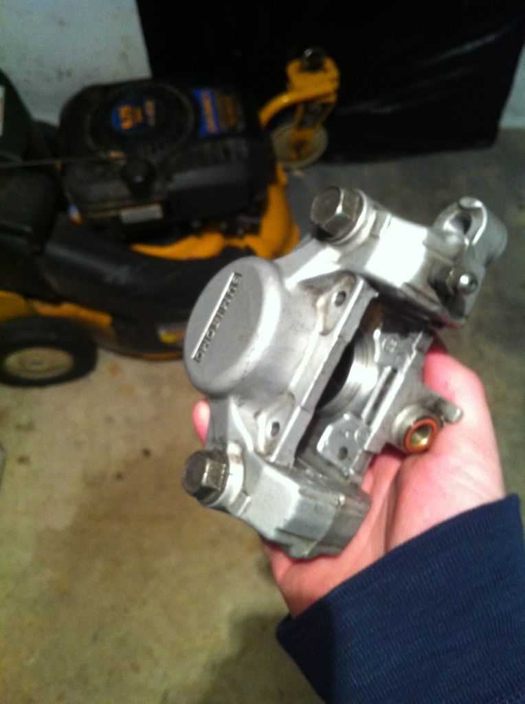

  18. ryancdossey
    ryancdossey Member
    825
    Indianapolis, IN
    So does your have just one of the bigger circle things inside of it? The part that the oil presses agains the other piece that presses the pads? Mine has two of the large circles on each side... Someone give me the right term here lol...
    Got mine good and clean. A whole can of brake clean, a shop rag, and a tooth brush later.
    Thats a shot of one of them. So it looks like I have the hole where the brake line went to and then some other nozzle? no clue what that one does....Do I remove those two bolts to open it up?
  19. ColoradoDan
    ColoradoDan Active Member
    433
    75
    Longmont, CO
    Yep, just one piston to push the pads tight. Someone will definitely chime in soon about the two sides on yours.
    LOL, "some other nozzle" is the bleed nipple, and its fun to say it as often as needed. That's what squirts out the excess fluid and air when bleeding the system. I cut my teeth with hydraulics on 70s corollas, slumming my way thru college in the 90s, which is why this was easy for me. Pay off for being a starving student.
    Its easier than it appears.

    if you use grease, how will you get it out of the passageway that connects the 2 halves of the caliper
    blast an aerosol ,maintenance spray, or wd40 through the pasageways , from inside the bottom of the piston pot,
    then blast carb or brake cleaner through,
    then blow with air line, or an aerosol air duster
    stu.

    Thank you very much for the advice. What I found the easiest to do.... We broke the caliper apart into two. Used an air gun into the main line hole on the one while holding the two small holes on the sides shut. Popped right out. On the other side we simply went in the bleed nipple side and held the two holes shut by hand again. Popped right out.
    Just in case anyone else runs into this.

    I used compressed air on my GPz and stuck the air gun nozzle into the line hole. To get a good seal I wrapped electrical tape around the nozzle end. They were stuck good but when I shot the air to them they popped right out. After the first one I learned to point the piston down to the floor so they would not go flying across the shop with the seals also shooting out.
    Just saying there are all sorts of ways to do something and sometimes if you just look a thing over and think about it for awhile you may get ideas. There is also something to be said from getting ideas and knowledge from people who have been there. This site is full of people like that who are willing to help.

    Pretty much what we did on a radian. We held the cross passage holes down against a block of wood and shot air in behind the pistons to pop them. We had to use the seals that connect the holes to keep air from leaking out.
    By doing it like this the wood would catch the piston before it got all the way out, but it was easy to pull out from there.
