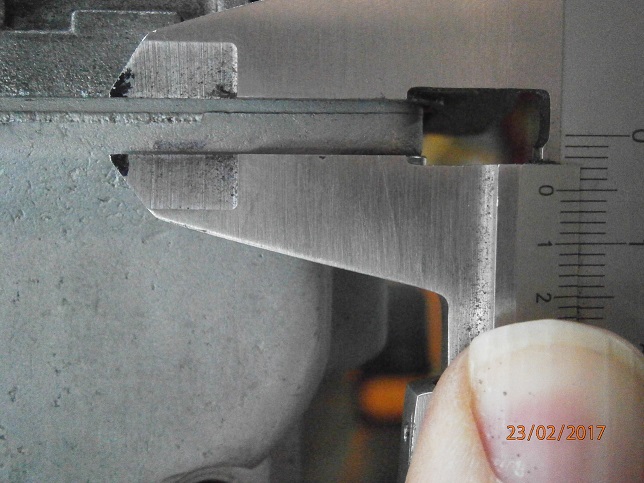

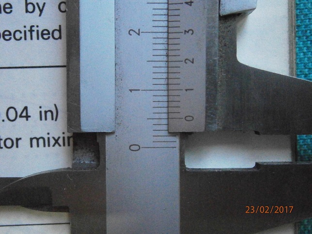

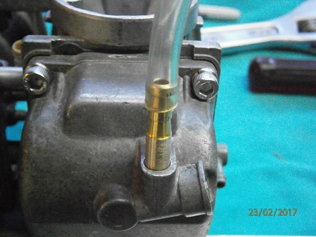

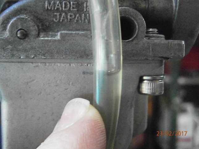

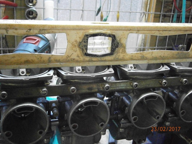

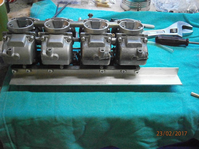

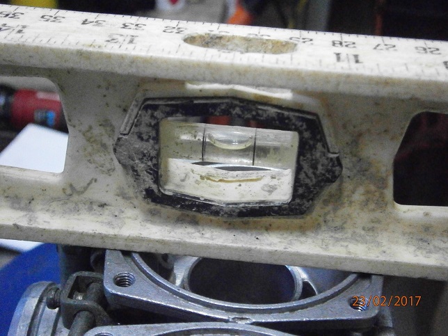

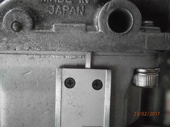

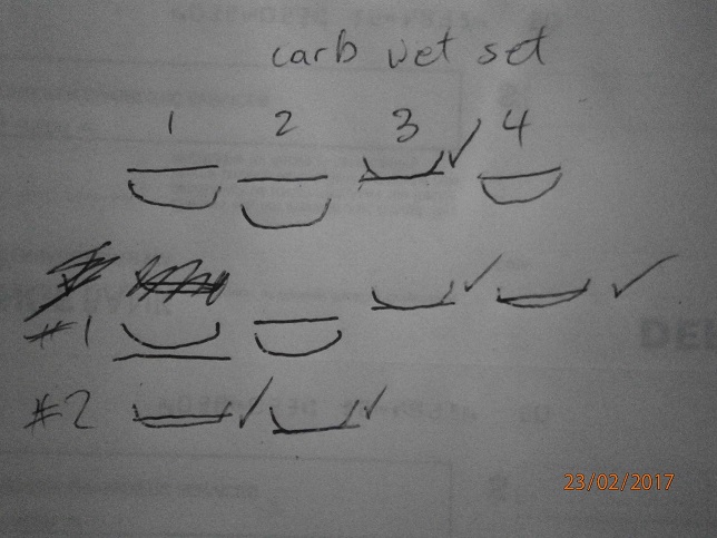

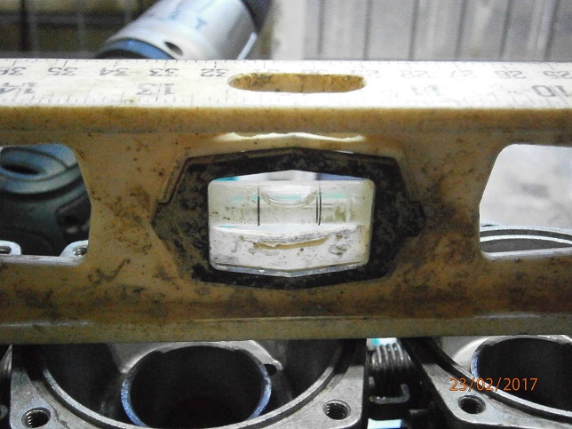

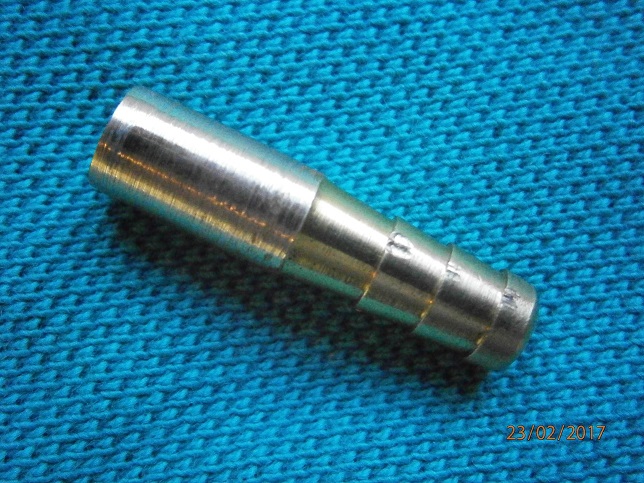

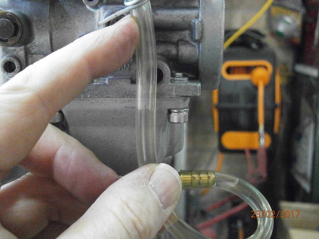

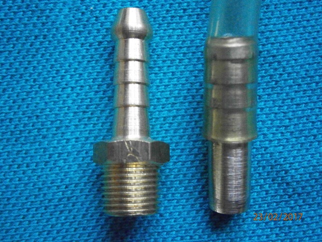

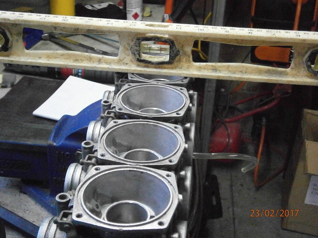

    Got another camera after ruining the last one with oil and dirt so... thought I'd make a record of my recent foray into a wet-setting a set of Mikuni BS36s.
    1. change the philips screws to cap screws (no push pressure to undo and tighten).
    2. make a carb holder to fit in the vice out of some aluminium T length and level it in vice.
    3. make a suitable nipple/barb to plug into the waste socket.
    4. mark the outer bowls with the correct measurement.
    5. do an initial level.
    6. alter each tang to get a good reading.

    FYI. The carb holder bracket is secured only by the outer to 2 cap screws, although I removed the inner 2 cap screws holding the idle screw too as it was sitting proud of the plate.
    The other heads of the cap screws are just poking through big holes.
    Not sure if that was obvious from the picture.
