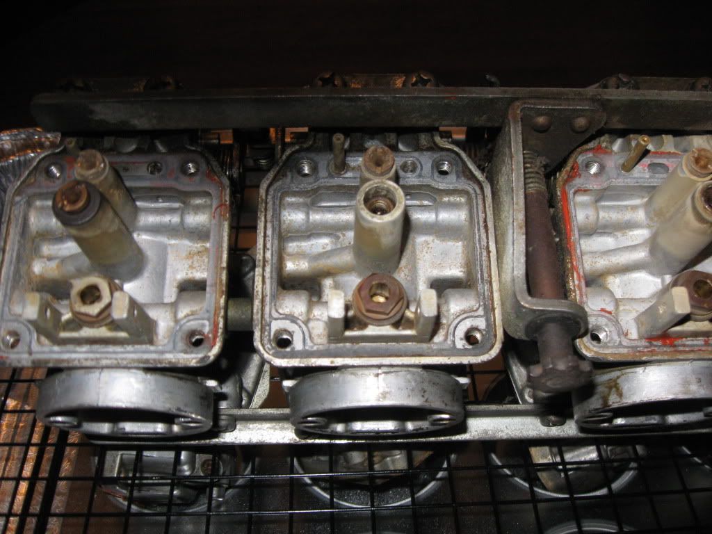

    Picture showing what I think is a threaded insert that the main jet threads into

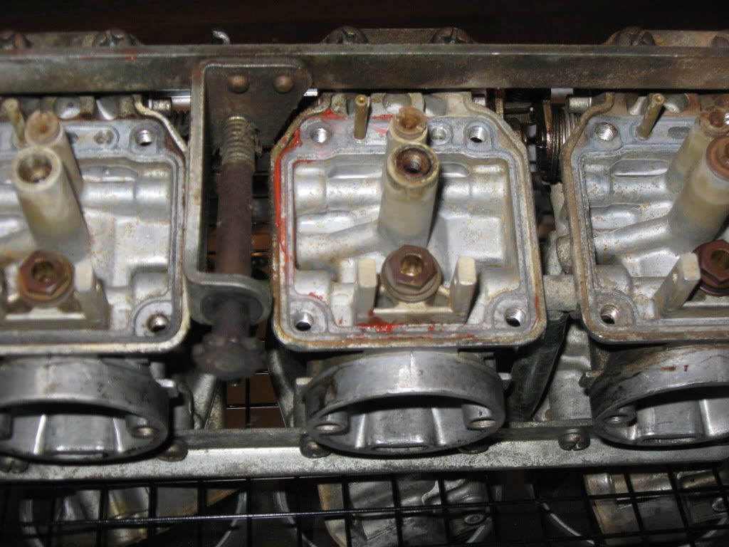

    Picture showing the carb "missing" the threads
    Thats what I am looking at. Nothing came out with the jet, nothing fell out of the carb. The jet "broke" free with no effort (not sure what was holding it in to begin with)
    So is the carb junk?
  6. sanyarcosean
    sanyarcosean New Member
    Shrewsbury, PA
    Never mind... I see it now. I slid down the bore but does not seem to be able to slide out the end. Is this normal?
    Sorry all, I feel like a doof...
    Sean
  7. schooter
    those carbs need to be cleaned... I see why it didnt thread... the emulsion tube slid down... if you look in the "tunnel" (thats what i call it) of the carb, the main part, you'll see a little brass part sticking up from the botton, use a screwdriver and push it down and you can thread the jet in
  8. RickCoMatic
    That Brass object with the threaded-end is called the "Emulsion Tube"
    They are lightly-pressed in from the TOP of the Carb.
    You will have to REMOVE all four and clean them.
    The easiest way to remove them is to TAP them out through the TOP.
    I use a long Cap Screw with the same thread.
    Screw it into the bottom of the Tube and lightly drive it out the top.
    You have to remove the Chrome Top, Spring and Diaphragm to access the Top of the Emulsion Tube.
