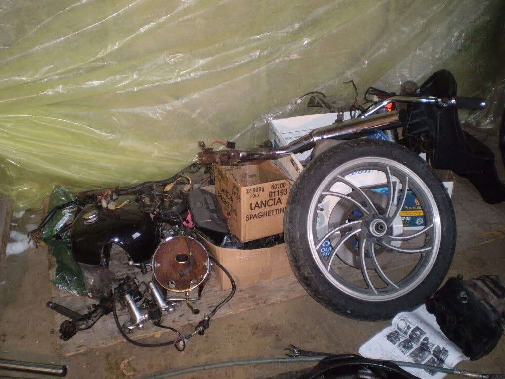

    Finally got to start work on it tonight. Took the signal lights off and found out that 2 of the lens screws had broken off inside the housing so I might need a new set of signal lights if I can't get them out. Got the mirrors, tank and headlight off, and was about to remove the passenger pegs and start disassembling the rear brake to check for delam when I snapped the bolt on the rear brake lever. Balls! I'm guessing there is a groove on the shaft that that bolt sits in, and you can't get the lever off until that screw is out, right? I'm guessing I'll have to drill out the screw and all that fun stuff. Anyways, got a couple pics of the progress so far.
