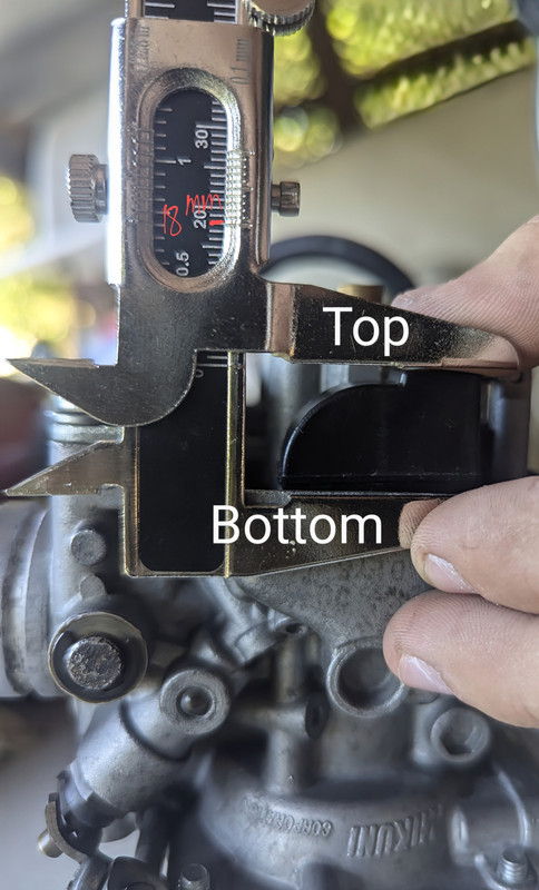

    My friend had the bike for a long time and he never winterized it, and you can guess what happened. After rebuilding the carb and cleaning it out with carb cleaner the bike would start, and then just choke it self from the fuel. I had taken apart the carb 4 times and it looks like the float needles and move freely and the float height is correct. I even synced my carbs with a home made manometer, even tho I didn't have the YICS tool. I honestly have no idea why it's flooding!!! I even changed the fuel filter I litterly tried everything. Please help!

    Took the carb out again and removed the float bowls, I did a little test to see if it's the float needles are leaking. I plugged up the fuel tank took off the floats and just put the needles in the seats by then selfs, turned on gas nothing, took the them out and surly there is gas squirting out. So that rules out if the needles and the little brass thing the needles goes it are bad.
    I also measured the float when it's upright as I push it with my finger which is 18 mm, isn't it supposed to be 20-21 mm?

    Not sure what you are doing here. You should never take any measurements while putting any pressure on the floats. You also should be performing a wet set of the float levels. That is the ONLY way to determine how high your fuel level will be in the bowl.
    Are you sure you have the right carbs?
    Mikuni BS28 (all XJ550 except 1984 XJ550L):
    -Fuel level measured via the clear-tube gauge: 2mm +/- 1mm (.08 +/- .039 inches)
    -Float height: 21.5 +/- 1.0mm
    As you can see the fuel level is supposed to be 2mm +/- 1mm with the BS-28 Mikuni carbs.

    Ah, I see! hmmm I always thought I had BS34 because the BS28 had some weird tubes coming out of them and my carbs don't have that.
    I'll check the float height again when I get home, also what do you mean by "perform a wet set" is there a guide on how to perform it?

    The floats are all correct height of 21-22 mm and the fuel level is correct aswell.

    Holy shit! I found out why all of this was happening!!!! So there is this rubber gasket on the float bowl and when you screw in the float bowl it expands! and guess what! the float was getting stuck on it . I just took all of them out and stretched them, so far no leaks and no mega rpm problems!
