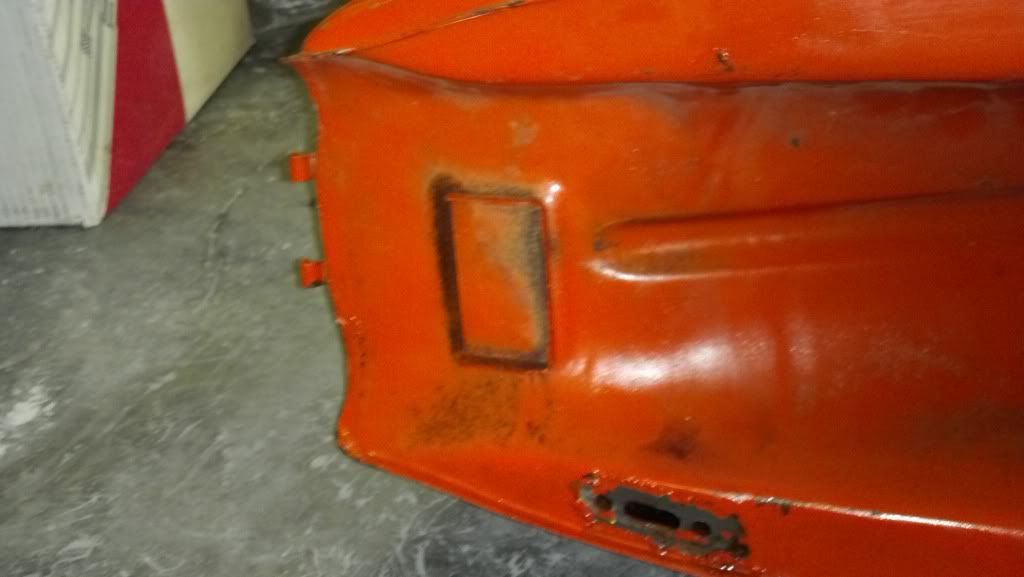

    I got this tank on ebay and its pretty solid but I have no clue what it came off of.

    I think that's an old honda color. 360 ? Not sure

    No idea myself, but the indentation for the nameplate looks a bit long for Honda. Kawasaki, mayhaps?

    Not sure - most tanks of the period from the big four had hinged, locking caps, whereas this is just a plain screw-on. Thinking poss Suzuki?

    Friend had a suzuki 185 with that style tank. Older bike

    The petcock hole looks Yamaha-ish but could be any Japanese manufacturer (which does narrow it down) and those two tabs at the rear are part of a HINGE of some sort... they look very similar to the frame tabs for the Yamaha seat pivots on the side-hinged seats. Again, more evidence of Japanese lineage rather than necessarily "Yamaha."

    the ebay ad claims it Yamaha but I can not find a pix to confirm what it is so I can get parts for it.

    After another look, think it's a '73/4 RD200 item.

    Mid-late '70s Suzuki; probably GT185. And here's why: Those tabs at the back of the tank aren't part of a hinge; they're hooks to engage the tank retaining strap. On those bikes (I checked 1973 through 1977) the rear of the tank is held down by a short rubber strap with a wide rectangular metal clip that engages those two tabs. Here's a pic: http://www.ebay.com/itm/SUZUKI-FUEL-TAN ... 56332683fe
    The wide clip hooks on the tabs.
    Some of their dual-purpose/enduro bikes used a similar tank retaining system so it might be a different model.
    Oh, and it looks like Suzuki may have been using petcocks from the same manufacturer as Yamaha at the time.

    I think you're right Fitz... I thought GT 185 earlier, but dismissed it on account of the screw cap. However, GT185M/A/B had these, prior to adoption of the hinged one.

    I know its not a 360 honda tank. the petcock hole for a 360 is round. The cl360 was my first bike. But that color is very close to what mine looked like.
