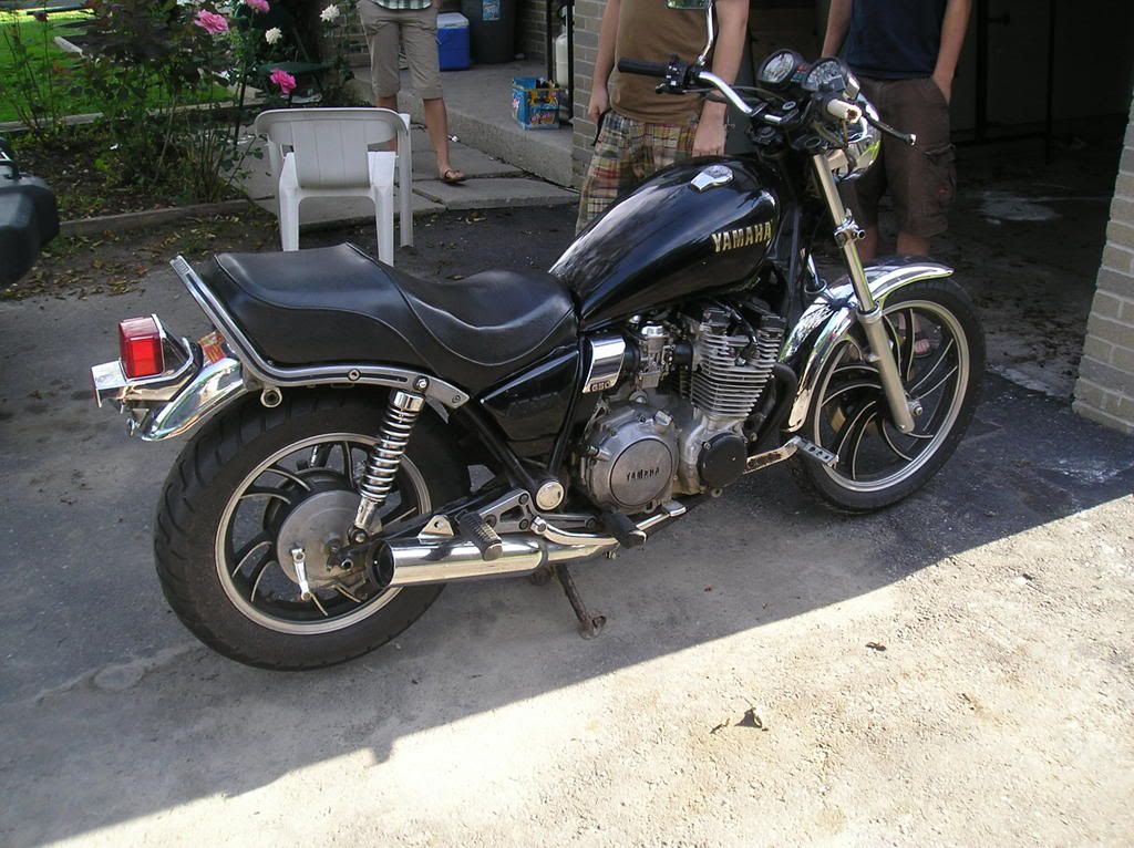

    well i just purchased my fist road bike and its a 81 yamaha xj maxim 650. it has a 4 into one exhaust new tires and the rest is stock and i got this all at a really cheap price. the only problem is with the carbs from what i can see. thier seems to be a leak between the #1 and #2 carb on the fuel rail, and when i start the engine the bike runs nice when i have the "choke" on but as soon as i get off the choke the rpms die and the engine sputters out. now if u try to keep the rpms up while doing this it backfires and slowly dies. now i figured it was running rich but i checked the plugs and all four looked golden brown so it has me stumped!!! would it be running too lean? compression is good all across and the engine has 55000 kms. also this might sound stupid but is there a way to check the oil level?
    any help would be great this is starting to bug me haha

    Welcome to the site ian354, look at the first picture you posted. Above the rear brake lever you can see a small window used to check your oil level. If you look at the motor casting beside the window it's marked with two lines, keep the oil level closer to the upper line.
    I would suggest you pull the carbs off the bike and clean them thoroughly and also change out the fuel rail orings. Do a search on this site for carb cleaning and you will find many topics covering this subject.
