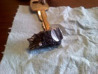

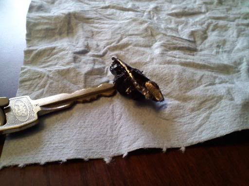

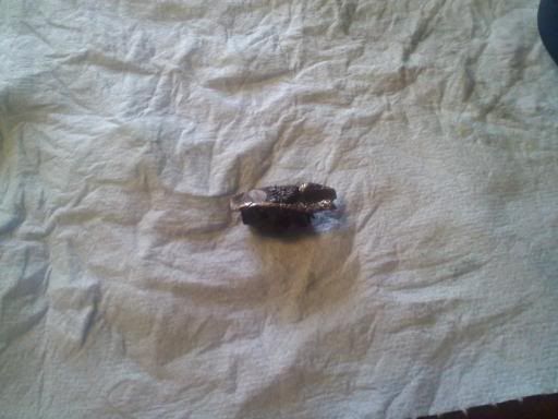

    Thanks to Bike Bandit I found that the piece in question is the "oil pump cover". Still unsure of it's job. I think I found what knocked the cover out, and I'm unsure what it is. I took the bike for a ride today and was unable to shift lower than third. Limped it home and found this on top of the transmission shafts.
    HELP ME haha
  11. schmuckaholic
    2,260
    42
    California
    Cam chain guide?
  12. QuarterHorse
    QuarterHorse Member
    141
    Des Moines, Iowa
    After an hour of staring at Bike Bandit's schematics that's the best I could come up with, but there seems to be a lot of plastc on this piece for a cam chain guide. I don't know, and I don't want to ride the bike without knowing, and I don't want to split the cases either. Grrrrr.

  14. schmuckaholic
    2,260
    42
    California
    It would certainly explain the shifting problem, although the common complaint is that one can't shift up beyond first, rather than down from third. <shrug>
    I've not had to deal with this issue, so I can't really say for sure. However, I was under the impression that a) the cam chain guides, for the most part ARE plastic, and b) it's not necessary to split the case to replace them; removing the head and cylinder block would be sufficient.
    Perhaps someone who's swapped theirs out can hop in here...?
  15. wizard
    The tensioner blades are steel backed rubber, you don't need to remove the head, just the inlet camshaft, me thinks.
  16. schmuckaholic
    2,260
    42
    California
    Quickly looking at the service manual, I get the idea that the front guide can indeed be removed by taking out the exhaust camshaft; however, the rear will still require removal of the cylinder block, due to the mounting bolt at the bottom.
    Again, I've not done this myself, so I could very well be way off base on this. The Haynes manual seems to bear this out as well, though. I've also got email on its way to Chacal to get his opinion.
  17. schmuckaholic
    2,260
    42
    California
    Okay, I stuck my foot in my mouth again.
    Chacal reminded me what the "emergency guide-ectomy" on the XJCD actually said, and I missed; it's not the cam chain guide that's the problem. The starter chain guide is the culprit. Currently, the only way to get to it is split the cases, although Chacal is trying to develop a method for getting around that. (He does, however, say that even if this method works, the ability to curse fluently in multiple languages would be a plus.)
  18. chacal
    9,164
    1,973
    The oil pump cover is quite a bit bigger than that piece, if I recall correctly. But it does "mount" via two hard-plastic u-shaped grommet "thingies". Hard to tell from the picture.....
  19. QuarterHorse
    QuarterHorse Member
    141
    Des Moines, Iowa
    I didn't differ what I've found very well in text. The oil pump cover isn't what I've pictured, but it was a little chewed. I had removed that and went for a ride, THEN the bike would not downshift passed 3rd gear. I brought it back and found what I took the pic of laying on top of the trans gears.
    Hope that helps.
