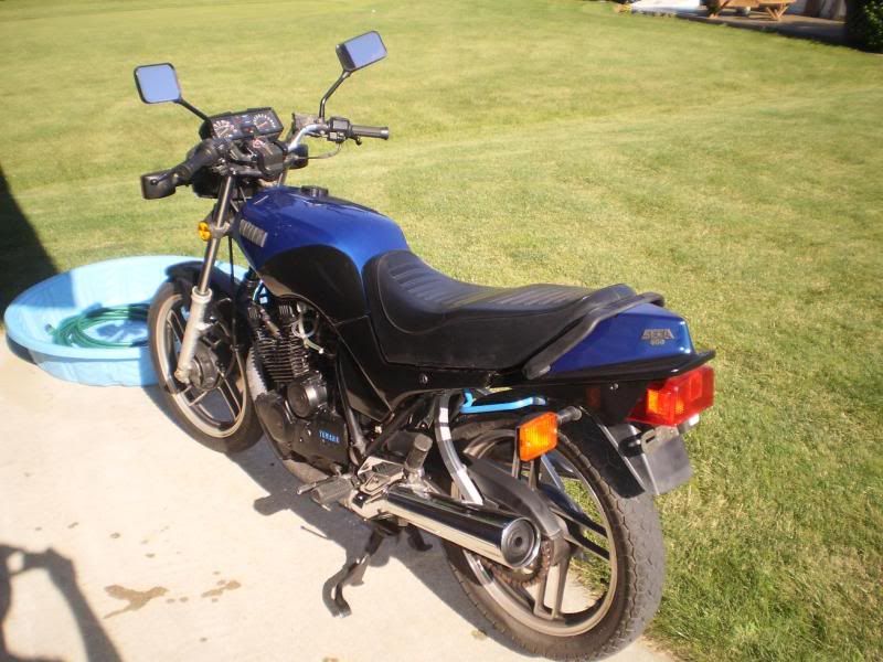

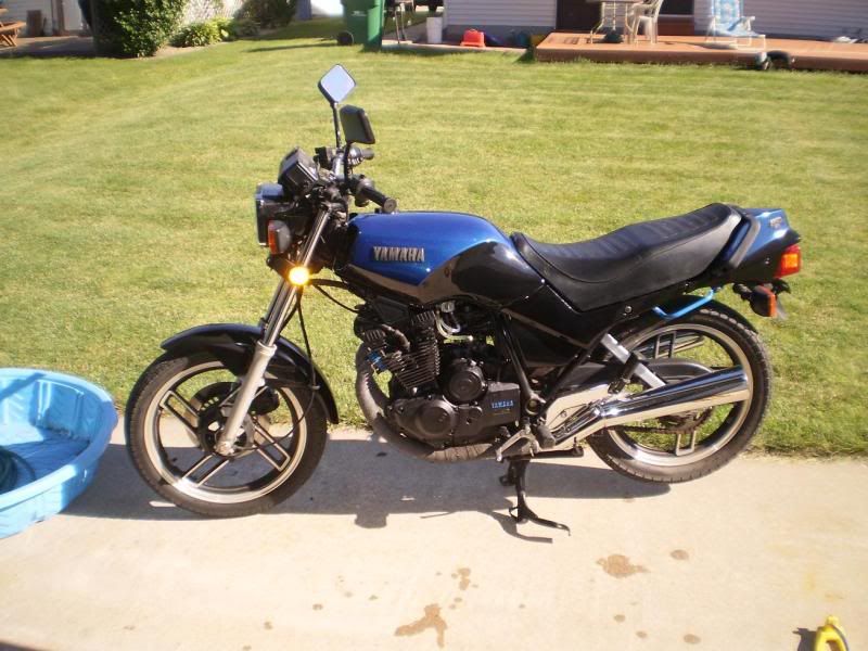

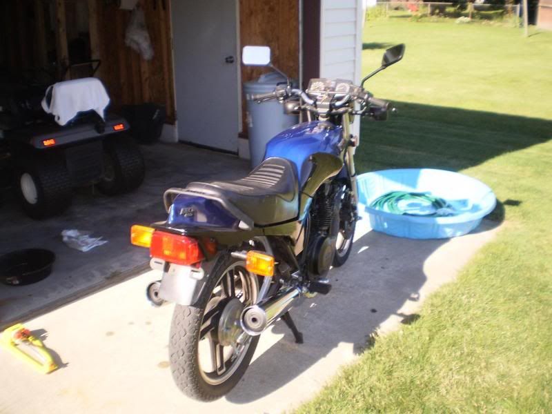

    put a bit of elbow grease in and it is a runner now! Turns out the float valves were toast. I threw in some spare I had from one of my previous 400's and it purrs like a kitten. I threw in two new D8EA's put on a missing airbox side cover from some of my spare parts, tightened the slop in the chain, ditched some cheesy LED lights that were under the rear fender, and put the proper size fuel line on it instead of the vacuum line the PO had on it. Rides great, starts fine, and everything works. Not a big fan of the paint scheme but I am gonna leave it alone and just flip the bike for some $$$. It only has 2980 miles on it and it has a clear title too.

    I forgot to add that I changed the oil in her to some fresh 15w40 too. I also replaced a few missing bolts (airbox to frame). The tank has been lined, but the petcock works flawlessly, the tank musta had some leaks on the lower corners because someone welded on some tabs on the inside and outside of the crimp lip but it isn't noticeable until you walk up close to it. The black paint hides it well. There is a couple pieces of black tape on the seat hiding a couple rips I'd guess buit they blend in well. Overall though it is a VERY nice ride.
