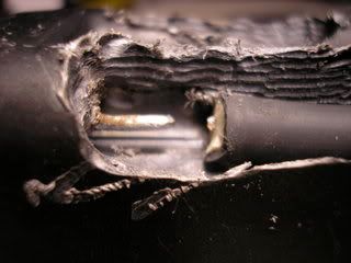

  4. snowwy66
    snowwy66 Member
    892
    Salt Lake City, Utah
  5. RickCoMatic
    Cut your Old Coils.
    Grab a couple of Plug Wires out of a BMW or Audi at a Junk Yard.
    Slip them fine Stainless Steel Cored wires into the Coil you opened-up for the new wires.
    Get the $3.98 5-Minute Epoxy (Black) , ... and mix you up enough to fill-up the Grinded-out space and cover the New wire.
    Use Masking Tape to create a little form around the space that needs filling-in, ... and just keep the 5-Minute filler coming until you have what looks like a Brand New Coil.

  23. RickCoMatic
    Performing the "Coil Surgery" is NOT that difficult.
    If you have an assistant Vacuum the flying plastic as its removed; It's not too messy, ... either.
    Cut the Coil Body open:
    DREMEL Tool
    Flex Wand extension.
    Carbide Cutting Bit.
    Starting 1.5cm behind the Wire outlet ... grind away 4.0cm of the Coil Case exposing the Spark Plug Wire.
    Free the Wire with a cut on each side.
    Pull the Wire out. Twisting the Wire free it from the Coil Body.
    Twist a New Wire in.
    Push New wire's center on to Coil's pointed connection.
    Using Masking Tape ... construct a "Form" to hold-in Black Epoxy resin.
    Flood the form with a mixed batch of epoxy.
    Grind, sand, mold and form repaired area to match contour of Old Coil.
