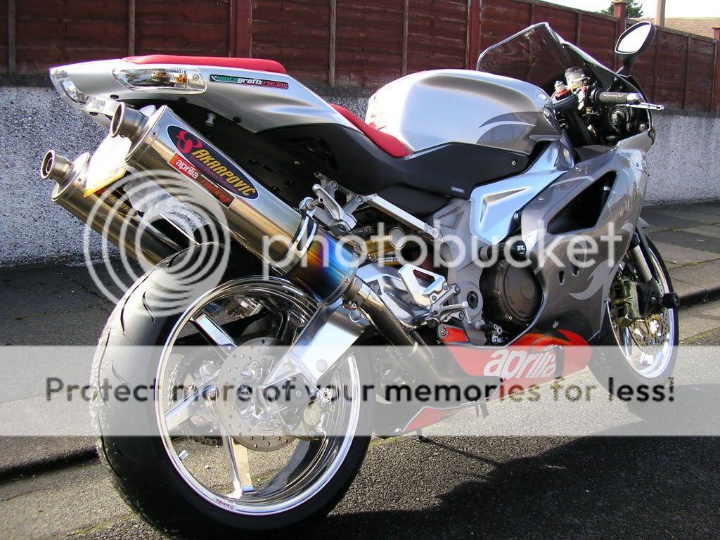

    HI RAZZ
    this my other bike and i use this on all the shiny bits and it smells lovely.

    Kawa, I like to be the first one to welcome to our little forum (if you call 6437 members small). Nice ride. The polish, does it guards against oxidation? I am looking for some thing to seal the aluminum after all the hard work of polishing is done.
  4. kawasakiinit
    kawasakiinit New Member
    22
    THANKS MATE
    no its just a polish really ,i am told you can get stuff clear powder coated these days but am not sure how that will work as there is no key on the subject to stick to ?
    i just ride mine in sunny weather and towel dry it after washing then i use the polish.
    i use my divvy in bad weather . my logic is if its shiny nothing will stick to it (other than dirt and chain lube?) lol
    however i did use this once and it protected my work scooter in winter but it does leave an oily film on the subject and isnt permanent .
    another option is to have the subject anodized ,if you look at my rsv swing arm and frame they look polished but they are actually anodized in that finish .the finish is pretty close to the polished wheels but not quite as good .if the wheels are 10 out of 10 the anodized frame/swing arm are 8 if you know what i mean . i would if doing it again go down the anodized route for sure as it is protected permanently but would research it first as there are a few ways of doing it i think...
    hope this helps ....
