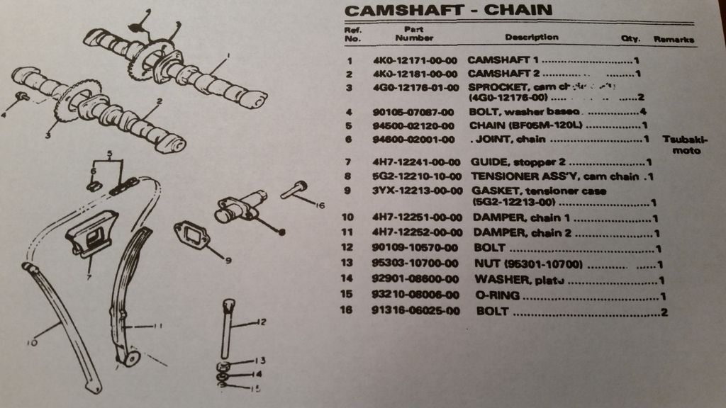

    What part normally disintegrates when they fail from being fragile due to age & wear ? Is it #7 - the primary chain guide or #10 or #11 - the dampers ? or a combination of all 3 parts ?
    Just curious.... pic is from '82 XJ750J Maxim Parts Catalogue.....

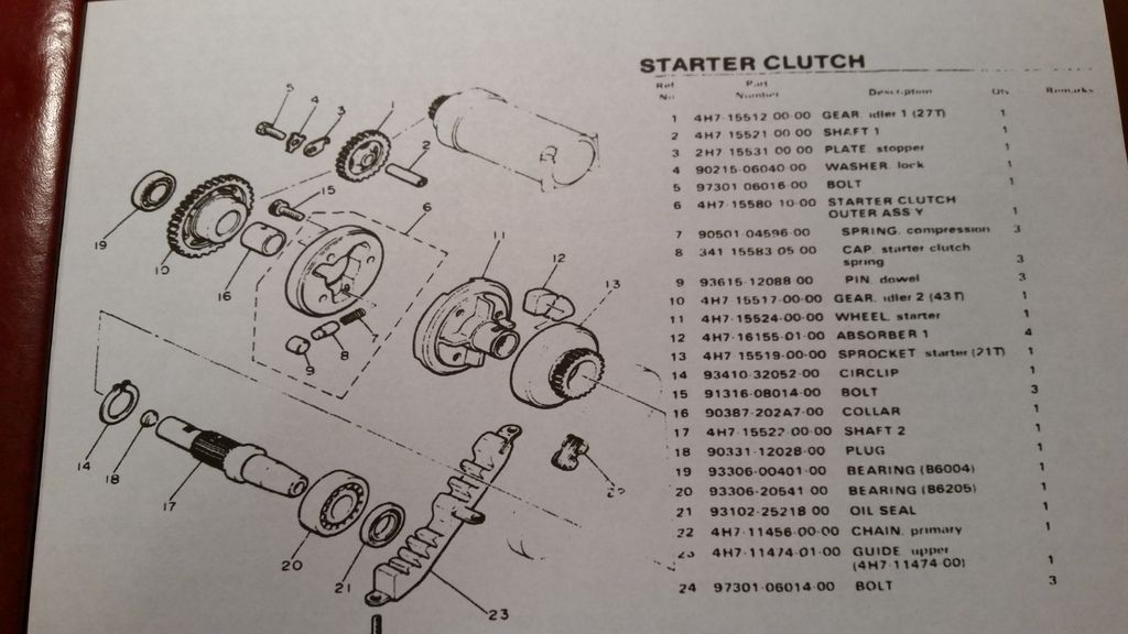

    so what you are saying then is ...it is the starter clutch upper guide that disintegrates ........& nothing to do with the parts that I mentioned above..... ????

    and one has to split the case to replace this part ???? What a PITA......hope mine stays intact.....

    your first picture is the cam chain guide/tensioner, that's not what guys find in the shift drum. i've never replaced those, probably wouldn't be a bad idea though.
    that #23 is what gives the problems, replaced a few of those. heat, oil and time take their toll on them. and yes it's a case splitter job.

    Part 23 in the 2nd diagram above disintegrates and chunks migrate all over your crank case. This causes the chain to flop about and wear on an oil nozzle not shown in the diagram. There is no true primary chain on these bikes... that chain is a... its a... umm.. it's 1 am and I remember nothing right now! Sorry. I give up. Hope somebody useful can help.
