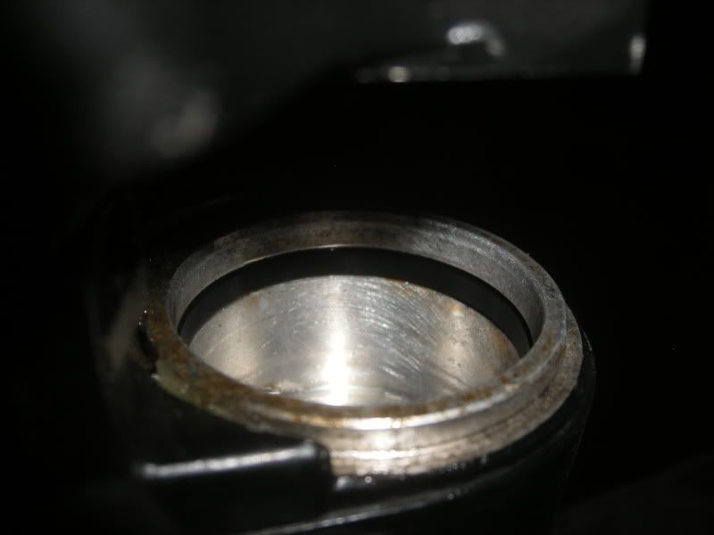

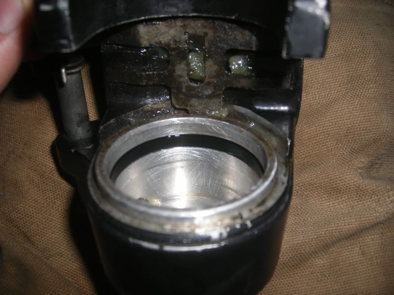

    Im starting to wonder if the seal might just be too big? i bought it from xj4ever and it seats in there pretty well. I can tell the bottom side of the seal is kinda protruding out though. tried to seat it as best as i could with no luck.
    I read somewhere else that a guy uses brake caliper grease to lube up the components. I may try this method. If it fails, im off to a shop to have someone pop that sucker in there.
    Tried about 10-15 times now. it only goes a quarter of the way in before it gets stuck. cant believe i managed 2/3rds the first time.

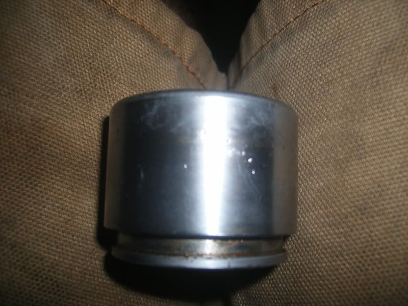

    Piston doesn't look horrible
    Not the best pictures, id say the bottom part of that seal comes out a millimeter past the bottom lip, only on one third of the caliper

  7. bigfitz52
    I just saw the pics afer I clicked "submit."
    In the very bottom pic, it looks as though the seal has a "lump" in it. If so, channel not clean.
    Also, get that anti-rattle spring out of there, and clean out all of the grease, etc. Once the piston's installed you won't be able to, and you do NOT want all that axle grease melting into your new brake.
    Re: the piston. I see some pits. Are they where the seal will "ride" when reassembled with new pads? If so, it's gonna leak.
