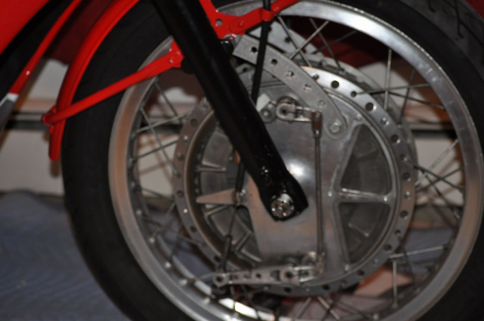

  10. k-moe
    6,756
    When talking specifically about the drum brakes of the 80's and 90's, I agree.
    But go back a few years.....
