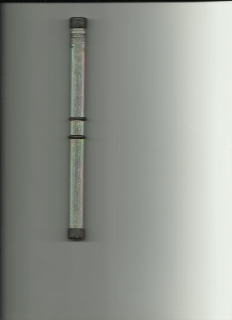

    Okay, this image is a bit on the big side and I cheaped out by just placing it on my scanner, but this is what is in the end of my bar on my Maxim-X. The bar weight has a vinyl cap on each end and a couple of rubber "O" rings in the middle. It should be just a friction fit but with age the vinyl or rubber bits may deteriorate to the point where you are getting metal on metal contact and THAT may be the cause of the rattle you hear.

    Did a neat little reply and posted a pic and then I must have hit the wrong button. So, this is what is in the bar of my Maxim-X...

    OOPS! Multiple posts. Well at least you can get a good look at it now.
