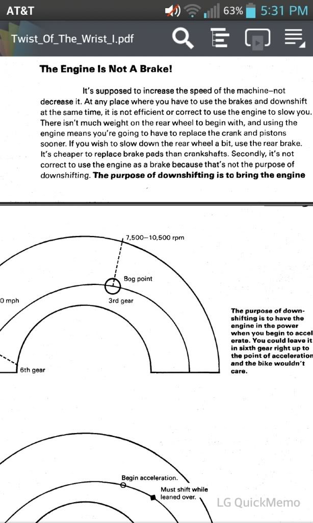

    It was pretty good but i have a question theu specifically said not to EVER engine brake. Thay it is used only for acceleration and using it to slow you down is a good way to destroy your bike.
    True or false?
    I do it slightly but normally just slightly in cooperation with my brakes.
    Do you guys ever do it? Not that big of a deal?

    thats a load of crap. if you wanna use the engine to HELP slow you down, go for it. its not going to blow up your engine using the engine to help slow you down a couple times a ride. it would be like normal running on the engine for an extra couple seconds each time you downshift.

    Two stokes NEED to (and generally can) carry more corner speed than 4 strokes (if racing). Engine braking is not a bad thing, unless you're specifically riding for the smoothest/ fastest lap time. Other technique authors recommend engine braking (I'm thinking specifically of Bob Bondurant's automotive technique book as an example).
    The only way that engine breaking will damage an engine is if you run above redline. Engines don't give one single "F" about whether or not they are working under acceleration, or under deceleration.
    Under specific situations (emergency stops as an example) engine braking can be better than using brakes alone.
  9. bigfitz52
    That book was written a long time ago, and applies to 10-tenths riding on the racetrack. It's still considered a road racers' 'bible' not so much applicable to the street. It applies to 2-stroke racebikes with maybe a 3000rpm useful powerband.
    A properly tuned XJ has around 7000rpm (8000 on the 550s) of useful powerband (from 2K to 9 or 10K.) Apples and oranges.
    Engine braking, especially with our bikes, can be a great contributor to the "haul-down" effort; and if just riding "snappily" only serves to bring out one's inner Ralf Schumacher.
    You won't hurt the motor.

    Four strokes won't hurt at all if you pre mix 2 strokes its a bad thing your cutting off the lubrication to the engine. My rd injection is in front of the slide but even then the pump is on minimal with the throttle closed. kinda like shutting off the gas for the oiling. The reason i say it won't hurt a 4 stroke is many racers say open throttle is good not rpm when braking in a motor as well as decelerating with the throttle closed helps seat the rings.

    Engine breaking on any 4-stroke street bike is fine, it actually can help break in a new engine better than not doing it.
    I do it, you should too, it's the "proper" way to decelerate.

    I kinda have to agree with Keith on this one. Its easier to trail brake into a turn to slow the bike. Engine braking although effective is much harder to control and will cause the back tire to lock up if not done properly.
    Brake input can be manually put in and has better controlled feedback to the rider than just regulating the clutch. This regulating the clutch to engine brake lacks smoothness a rider needs to be setup for acceleration out of the turn.
