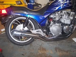

    here is the closest to stock i could get it

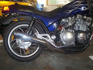

    here it is air all the way out
    look at the differance in exhaust location 8O
    P.S. sorry they are big photobucket resized them and the are still huge
    i have not rode it yet i am waiting on my risers no be finished so i am missing the bars lol
