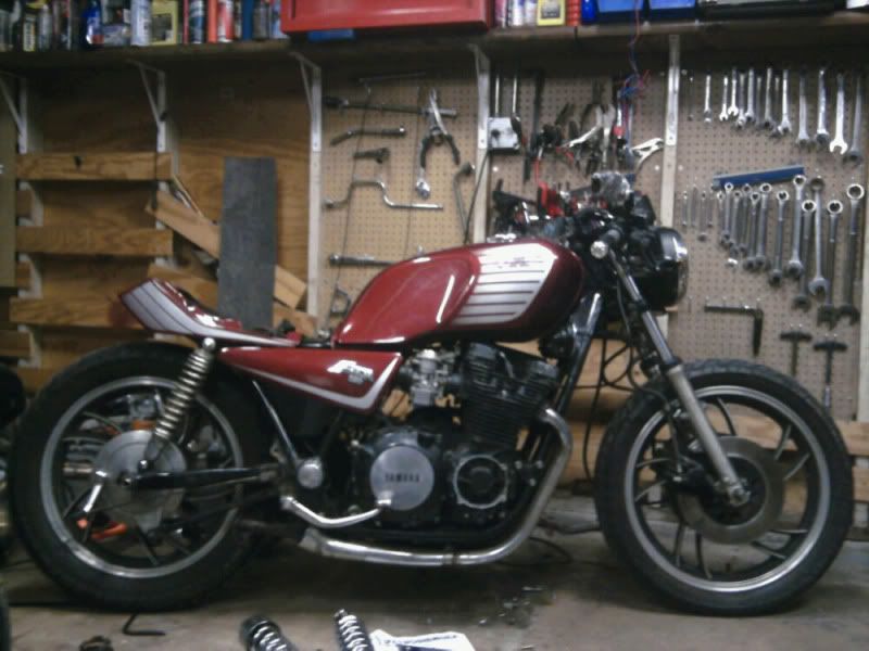

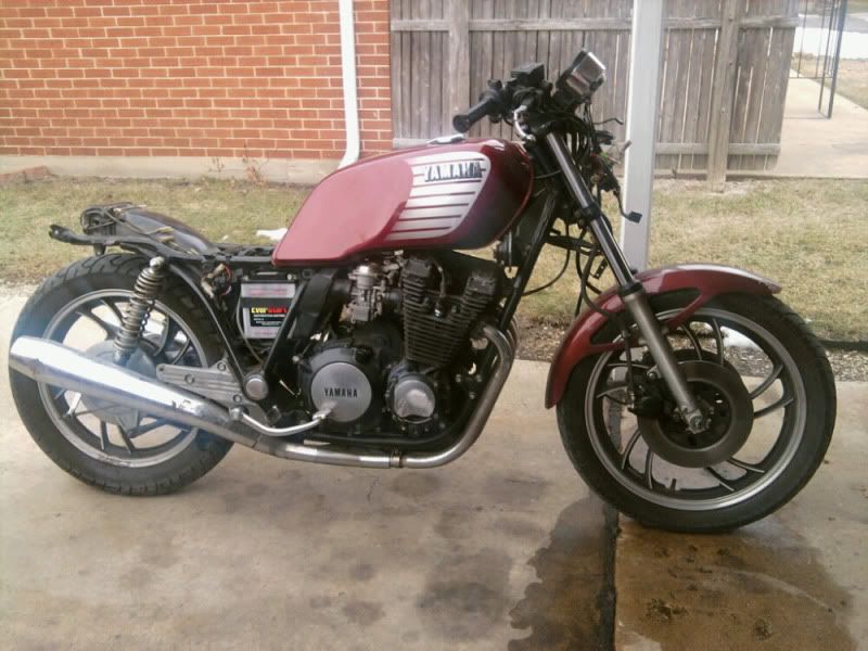

    This is the picture of the bike the day I picked it up (the picture makes it look a lot better than it really is)
    I took the front end of because the headlight ws busted and the bracket was bent, new parts are on their way.
    The tail section I'm just not feeling. This was the first day I took it out for a spin.
    Clubman bars came in, and I did move the forks up some 3/4 of an inch. I also took the dented exhaust can off to get to the shock, and put the rear fairing on to see how it would look if I reused original plastics.
    This is not the actual stance of the bike since it is on a tripot, so the back wheel is in the air.

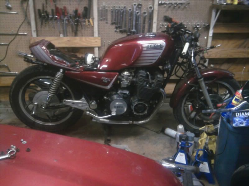

    Here it is with sportster shocks...
    The center stand is still somewhat usable since the bike sits without it, the bike sits maybe half an inch lower.
    You just can't turn the wheel because it's touching the ground.

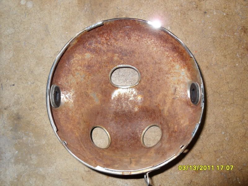

    Anyway, meantime I did a little work on the front...

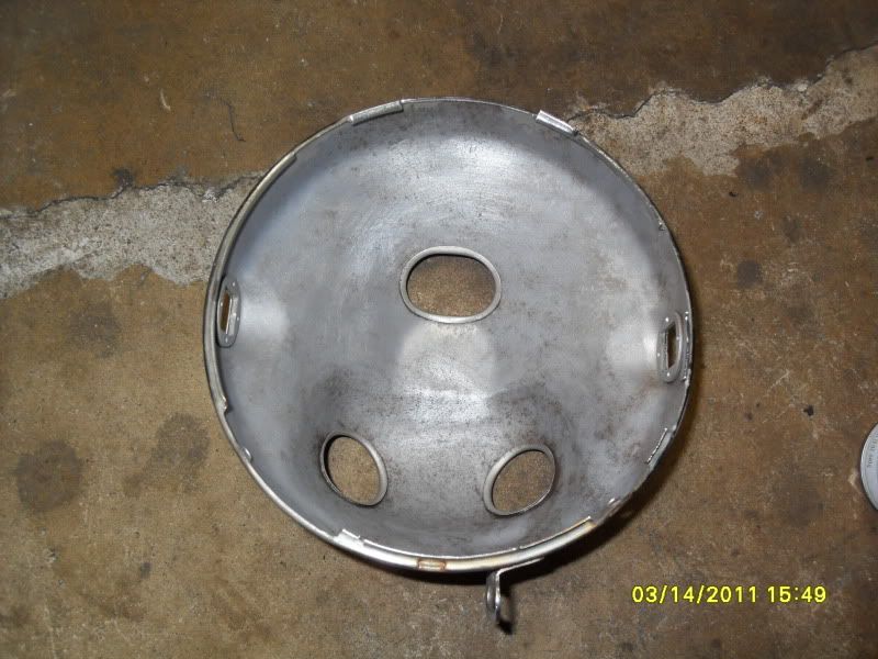

    I replaced the broken retaining ring...

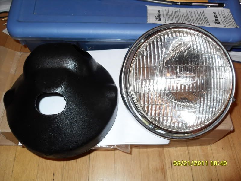

    Sandblasted the bowl...
    And then used roll-on truck bed-liner. I wanted it black anyway, and I figured bed-liner would be tougher and more resistant to chips than regular pain.

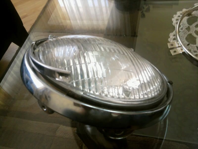

    Also made a new bracket for the gauge cluster that will lower it by 2.5-3" and bring it closer to the forks by about 1".
    Also put new headlight mounts which will allow me to mount the headlight so that the top of it is eaven or even a little lower than the top of the gas tank.
    I did the same to the gauge pods as to the headlight bowl.
    I also decided to retain the dummy lights, just sized them down.

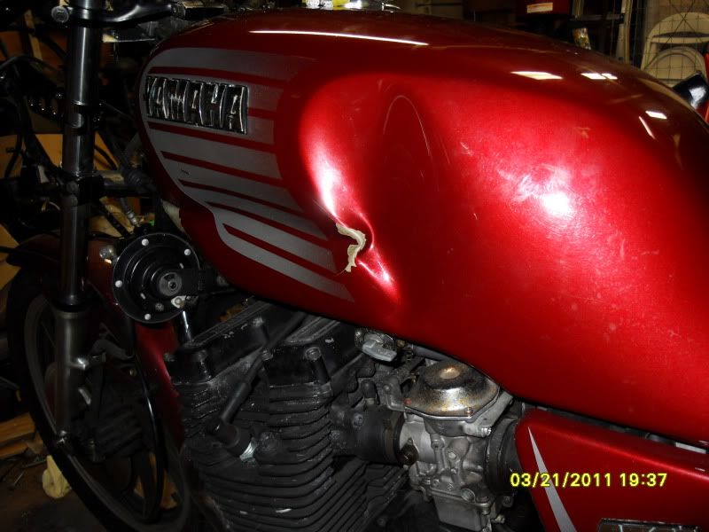

    And then here's that nasty dent in the gas tank...

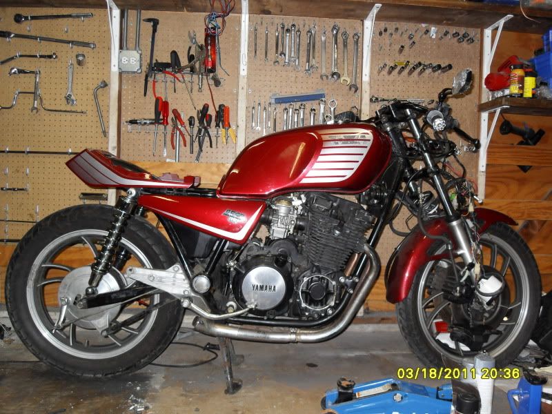

    Back to stock rear shochs... finished off the headlight as well.
    Took it out for a spin today. A little too cold for it, but stil fun :p
