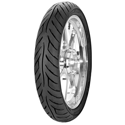

  13. xHondaHack
    829
    153
    Orange CT
    The Metzler Lasertecs front tires do have a center groove with a diagonal block pattern. Not sure if they are contributing entirely to the tracking concerns I have over all the new concrete they poured for the "Q" bridge that I cross back and forth on my commute to work?
    All I know is the rear Metzler that's on it now is totally spent and decided on a new set.
    So for comparison sake, this is the Avon "Road Rider" front that I will be putting on this season:
    The rear Avon's have the same style pattern, and I hope to give some feedback soon on their overall performance.

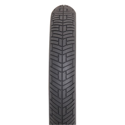

  21. quebecois59
    I put a pair of BT45s on my X and I've been very satisafied with how the bike has handled after. Front tire thread looked like that:
