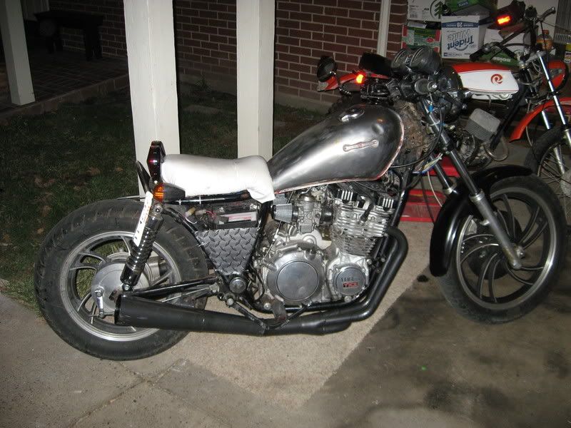

    Update on things. I had a little time to mess with it. Got my drag bars put on, oil change, and stuff set up now it's tore apart and ready for paint.[​IMG]
  18. xdarrickx
    xdarrickx Member
    Oklahoma City, OK
    What do you guys think of what i've done so far?

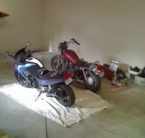

    Looks good. What material is the seat? Are going to stick with stock wheels or switch over to the spoked ones in the background? BTW, is that a 750 in the background? The only thing I don't like about my XJ is the lack of kickstart haha. But yeah, enough with the questions. Looking good!

    That seat is vinyl, i'm going to put on a spring white leather seat. Keeping the stock wheels and painting them. In the background is a '76 kz400. Guy at work got an itch after he saw mine... thats the next chop. I don't like the fact there is no kickstart and its shaft drive... but for what i gave for it and what i have invested i won't complain.
