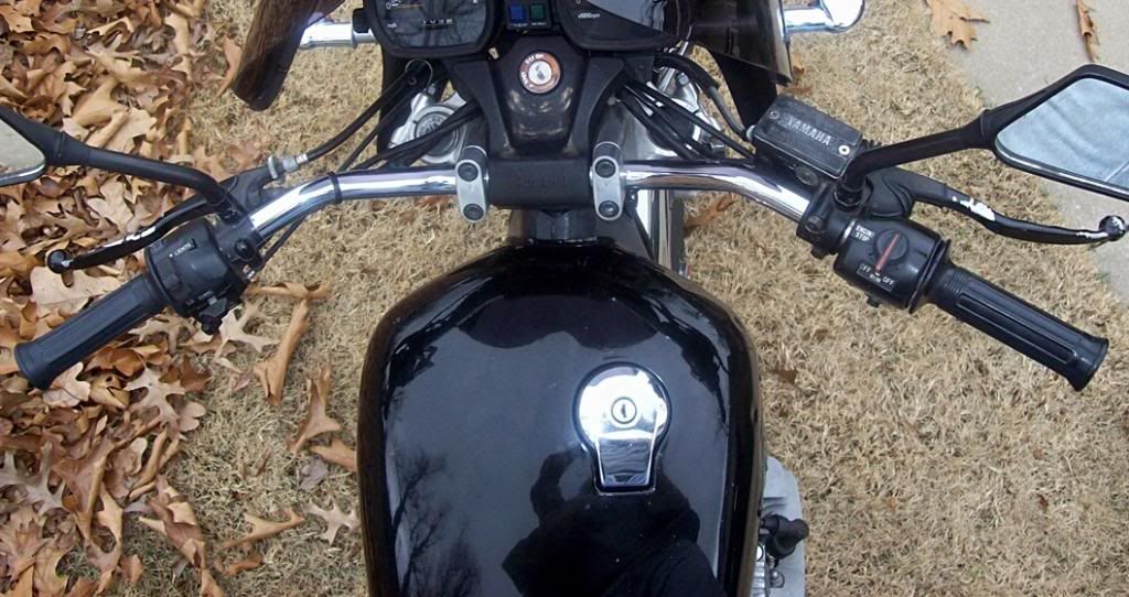

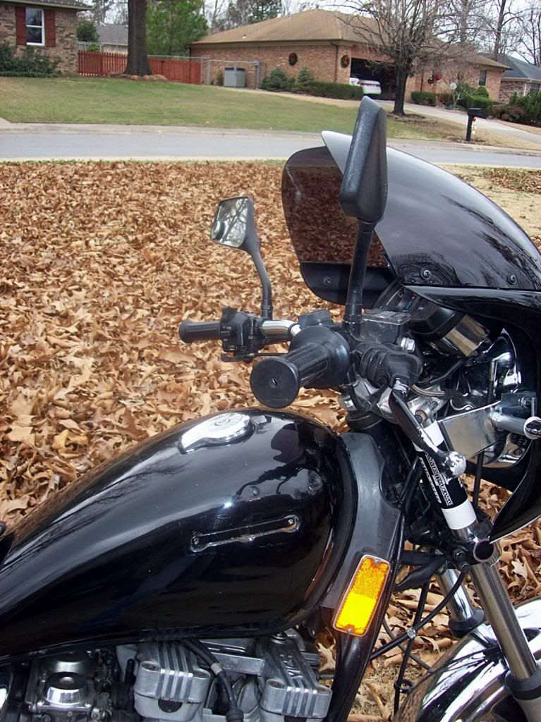

    How about just pictures instead. I think these will give you an idea
    View from the top...me peg standing and holding the camera above my head - yea my levers need refinishing and the ignition plastic too. :)
    Direct from the side..shows the rise well, the new fairing, and the leaf pile I need to tackle.
    Angled view
    If you notice the hand grips are sitting at about a 35 degree angle, I have an XV (virago) with stock bars that are basically the same as the XJ stock bars-To me the leverage is fine and even makes the Euro bend more forgiving, the rise is better, when you brake the force mostly passes through your hands and wrists and is absorbed by your arms (increasing control in emergency situations). On the stock bars your hands do much more work during stoping. So do you want to milk cows or punch the air?? 8)
    SS Lines are really quite set in their ways. Slack isn't as much of an issue as 'clocking' is, but slack can affect the clocking. The way the SS line approaches the MC is critical as it's not going to twist. If you do have issues you can get Chacal to customize your line (basically just take several measurements or mock ups and make sure he gets the right specs to custom make you one), or you could do what I did which was go to a local shop that specializes in airplane hydraulics, which means they can make anything and have them custom make you a line on the spot.
