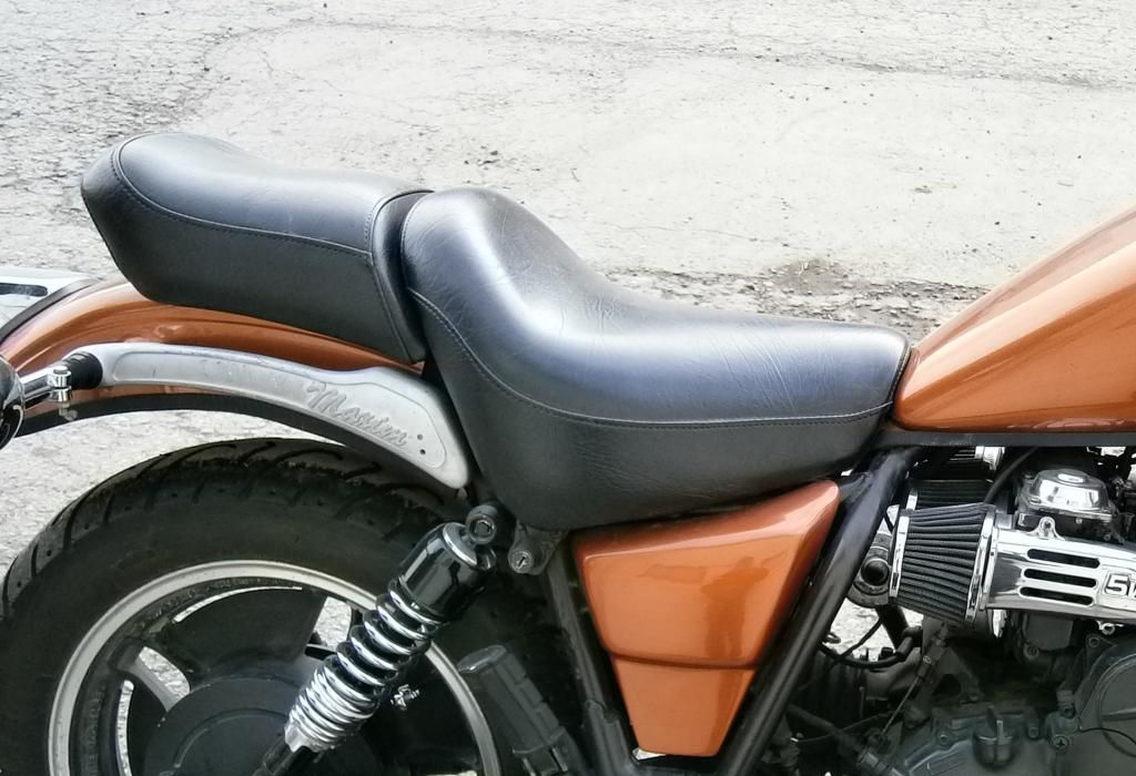

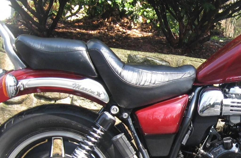

    The link above isn't working so here's a few pictures that may help give some ideas.
    Original style with lots of padding:
    Recovered Stock seat with smooth leather and no buttons:
    Custom seat foam and M&H long grain leather cover with buttons:
    The custom one is on my bike now and is still relatively soft, even though I did remove some foam in the center portion to reshape it. To help keep from sliding up into the tank when braking heavily I added foam to the front. The long grain leather cover is great at holding you in place.
    Tony
