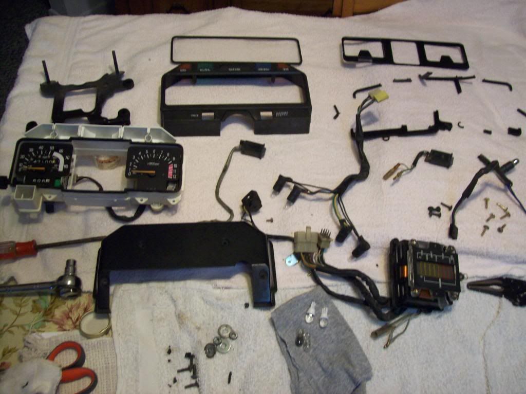

  7. TIMEtoRIDE
    oops :oops: well here's the "can-o-worms" shot

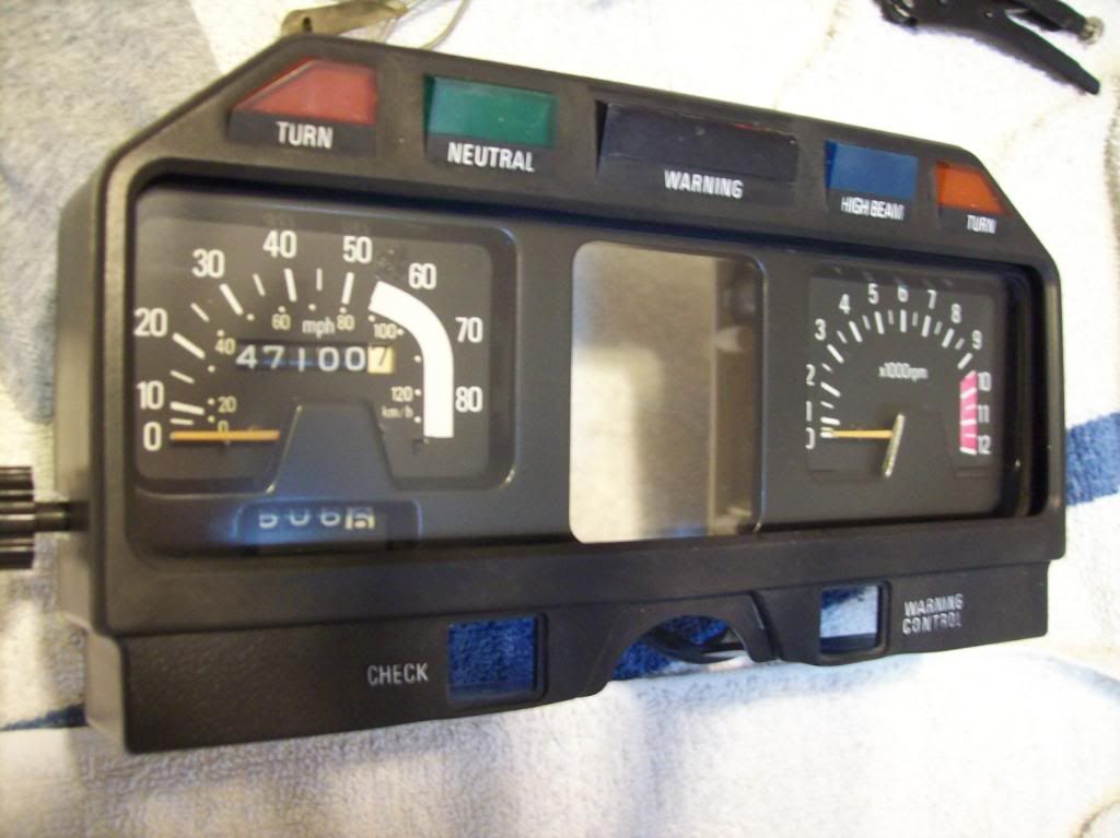

    and the mock-up with finished paint
    I may have to blend some paint and re-do the "55" to make it totally invisible

    Interesting that your tach still has red but the speedo doesn't anymore. Both mine are totally faded.
    Last time I had mine open, I repainted the needles with some DayGlo orange paint. Looked really good for a few months, but the color didn't last.
