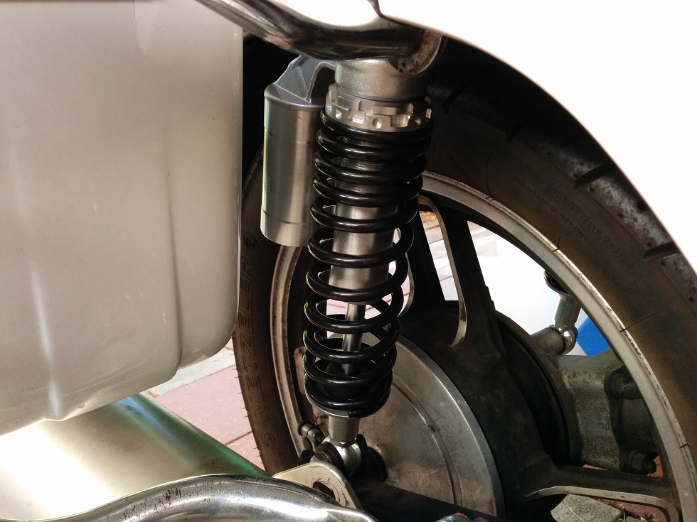

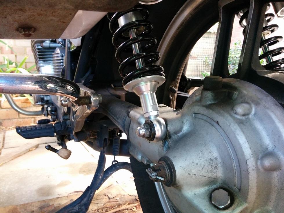

    Hi,
    I just bought a set of these shocks for my 750P.
    Keith put some heavier springs in(I carry around a bunch of extra weight all day) and set them to the right height for me... can't ask for better service and the price is nice too.
    Compared to my stock shocks these are BEAUTIFUL to ride on for me. So far so good!
    EDIT: Keith just let me know that the length wasn't locked in, although they were the right length. I'll be popping them off to apply the loctite that was supplied, later.
  12. adrian1
    adrian1 Active Member
    1,818
    Can you explain the loctite comment pls
    BTW that shock manufacturer has a presence in the Uk and the US
    http://www.tecbikeparts.com
  13. cds1984
    cds1984 Well-Known Member
    1,025
    245
    Perth, Western Australia
    The shocks are extendable at the bottom and they have a lock nut.
    They come with a tube of loctite and instructions to find the right length and apply the loctite and then set them up... I neglected to do that since they were already the right length!
    They haven't shifted either so... thats a win, but I will loctite them as per the instructions soon I'm thinking.
