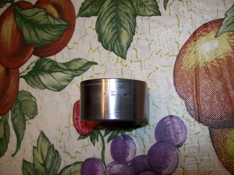

    Thanks for all the help with the caliper and brakes so far. Just pollished up these old pistons and the all looked pretty good except for this guy. Should I replace it. This break project is costing me a fortune, but I want to be safe.;

    Just wamted to add the bike was stopping before I decided to refurbish stuff. Just felt like it was important to start reduing stuff
  3. bigfitz52
    Where do the seals ride in relation to those pits? If they're in the area swept by the seals, especially the main seal (as opposed to the "dust" seal) then you'll have to replace it.

    Well good news is that a guy from church owns a bike shop and has a few spare calipers in his shop and is coming over today and helping put all new ones on

    822
    Staten Island, NY
