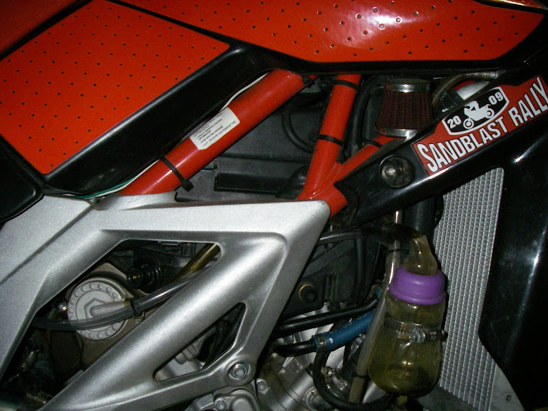

    **EDIT** Sorry about the oversize picture in the previous post :oops:
    When I used to race we did what TIME mentioned, make a catch can. You can get quite inventive as well as comical if you want. Just get a length of hose, black, clear neon, whatever and route it back to a conatainer that is securely mounted to some where on the frame.
    Low tech:
    High tech: sort of :roll:
    Hope this gives you an idea of what we're talking about.
    Cheers, Graham :oops: :oops:

    so i searched on internet and i saw a lot of catch oil hand made.
    i puted some creative and i do this..
    hope it will work i dont have time to ride my bike yet.
    critics please...

    Can you feel it blowing out the end of your pipe on the left. If that's an oil/water seperator or air dryer I think it has to have XX psi to function properly.
  8. bigfitz52
    Honestly? I'm afraid it won't work.
    First off, Max-X is right about the pressure required for a device such as that to operate;
    plus we've had a couple of folks who added a long hose to their breather to pipe it out the rear and it ended up effectively restricting proper breathing. What you've created may cause your bike to not run properly.
    What you need looks like this, and you would attach it directly to the breather outlet or at the end of a pipe no longer than the original hose:
