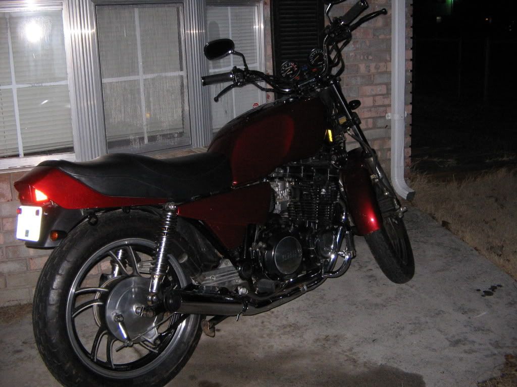

    Pics of the exhaust installed. I've got the carbs off and waiting for the rebuild components. The petcock is disassembled and I'm thinking my main reason for not starting must be dirty carbs because the tank and petcock are clean. I'll know whenever I tear the carbs down. Hopefully the parts get here soon. It's tough to wait when you've got everything all apart.

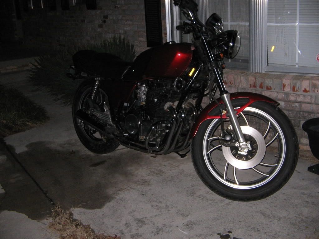

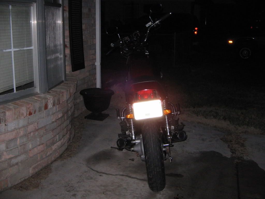

    Success! Sort of. :)
    The jet kit came in today, and as this is the first time I've ever attempted to rebuild any kind of carburetor, I took it nice and slow. It took me most of the day to get the work done and make sure I did it right. There was nothing difficult about it. I'm glad I decided to do it myself.
    At around 6, I put the carbs back on the bike and fired it up. It fired up. this is an improvement. Unfortunately, I've got a way rich mixture. Deep black exhaust.
    I hooked up my colortune to start adjusting and all I can get is an orange flame no matter how I adjust the mixing screw. I realize this is still too rich, but I adjust them all down as far as they will go and it runs ok. It doesn't like to do anything below 3k, but I decide I just gotta take it for quick ride anyway. :)
    The powerband is all jumpy. Nothing until 3k, pulls very hard until 6, flat spot at 6, 6.5 and up it takes off like a rocket. It was still a fun, if cold, ride.
    I guess tomorrow I'll go one size smaller on the main jets. This mixture is too rich even with the screws turned all the way down. The exhaust sounds really good. It's not obnoxiously loud, but it flows more than factory. I could still hear myself thinking inside my helmet, so it did just what I wanted it to do. And it looks pretty sweet, too!

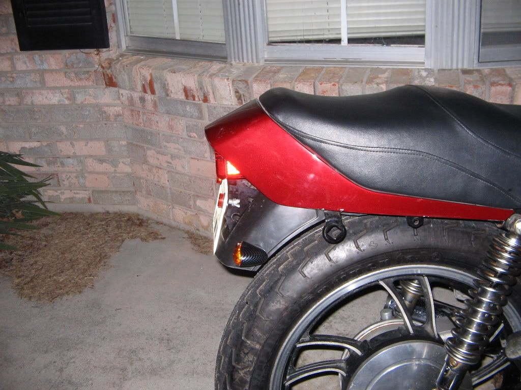

    I snapped a few quick pics to show the fruits of the last several days labor. Like I said in the "what did you do to your Yamaha today" thread, I've been polishing like crazy and I tucked the taillight under the rear cowling. Have a look!

    Thanks. I looked at your gallery and the original setup on your bike is where I got the idea for the taillight.
