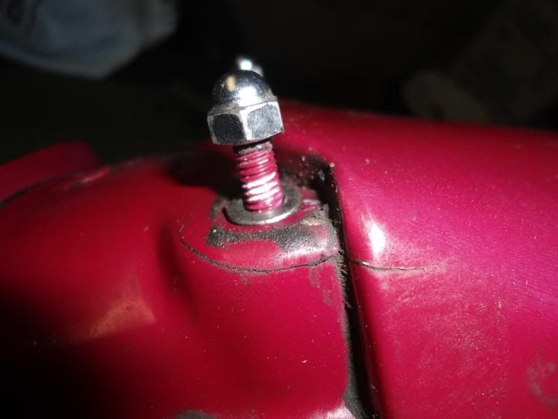

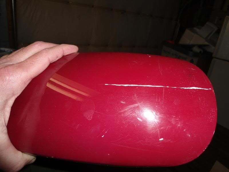

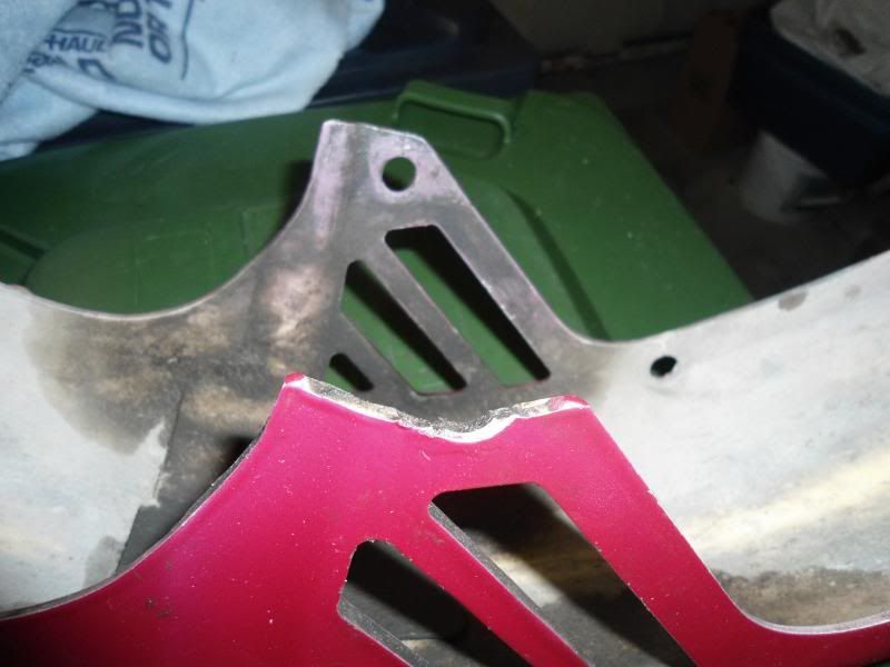

    Well, it turns out to be a bigger job to repair my front fender than just gluing it with ABS cement. The fender has suffered several damages over the years:
    Cracked but still pretty solid
    [[​IMG]
    One broken tab and the other one is cracked, probably the main reason why the fender vibrates a lot at idle.
    The only obvious crack before I pulled the fender off.
    So I think I may use the ABS cement for the split in the front end and the cracked tab, but I will need to fabricate a new tab with a piece of metal sheet and epoxy, I guess.
    What do you think?
  25. hogfiddles
    15,027
    5,280
    Seeing that........I'd replace it.
