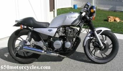

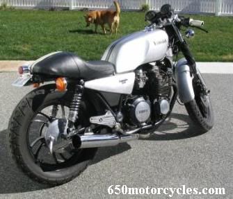

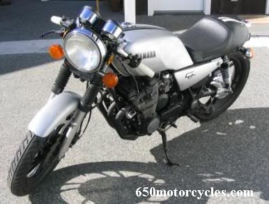

    Here's what I did with mine. Need to get an updated pic, been to busy riding it to clean it and take pics though! :lol:
    I didn't go for a real "crotch-rocket" style, but I did go for a sportier styled Maxim, and did it all for next to nothing.
    The exhaust is a Mac 4-2 which I got used off of one of my parts bikes. The headlight is dropped with a custom bracket (yes, it points towards the ground now), the rear fender is the stock piece with a good hunk sliced off of it, and new holes drilled for mounting. Painted all the other trim black, and put on some cat-eye mini-stalks. Also dropped the guages down to match the dropped headlight.
    Just another idea if you decide you want to keep the rear seat (which I did). I'll be building a much more radical sport-style XJ starting in January of next year, I'll be sure to update you guys. It's going to be a blend of old school and new school looks, with a bit more of a drag-bike feel to it.

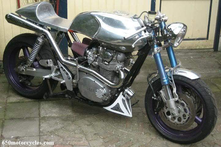

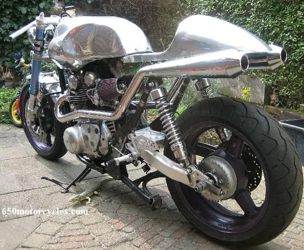

    Also, here's a few more pics I found for inspiration. One of my favorite XJ's ever:
    And while it's not an XJ, still a way cool bike:

    yeah....like that too me is sexy, but im looking at the real sporty type of bike...Im thinking about more of the street fighter style...take the exhaust underneath, or besides the seats....Raising the rear shocks up...which I dont know how to do....getting a rear set put on it...and hey guys....your opinion on these as head light.http://i3.ebayimg.com/01/i/08/b4/e8/66_2.JPG AND ALSO these http://www.tmfa.de/pics/hella/microde.JPG ....pair together as head lights....I want to be seen! :lol:
