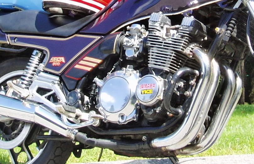

    only thing that bike needs are some stainless exhaust bolts
  11. RickCoMatic
    67
    Those are Stainless.
    So are the all the rest!
  12. schooter
    oh, they looked like the original bolts that are always rusty
