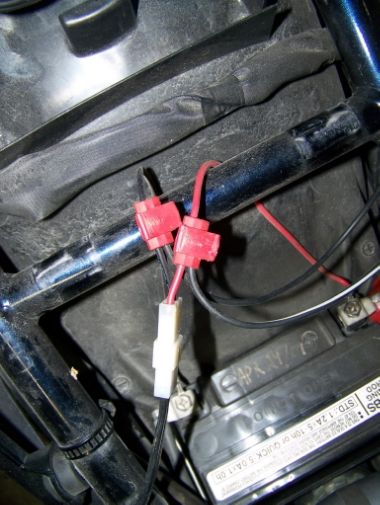

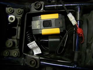

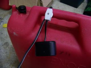

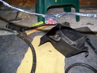

    Here's what I did on my Bandit for a power source:
    Picture #1 is a dual 12 volt source that I picked up at Crappy Tire, it had a little green LED on it to show that it's hot (seen better in #5). GPS plugs straight in to it.
    Picture #2 is how I spliced the black leads into the connection for my battery tender.
    Picture #3 is one of those little thumb roll on/off switches that you can put in-line for a table lamp. This way I don't have to have it on all the time.
    Picture #4 is an in-line 10 amp blade fuse to protect my battery.
    Picture #5 is a 12 volt inverter with a 110 plug so that I can charge my cell with "clean" hydro.
    I do have room to store this under the seat on the Bandit, but you could wire it so that it runs up to a tank bag.
    If you need more info or pics just ask. Hope this helps.
