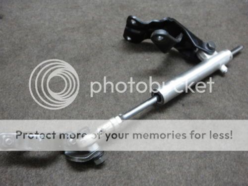

    The rear bracket in this pic (actualy composed of two brackets) attaches to the gusset that is between the downtubes. The front part of that bracket bolts to one of the oil cooler mounting holes, and the rear part bolts to the set of holes above those. The front (fork) bracket attaches to the left fork leg, far enough below the lower triple clamp to allow free mtion without hitting, and far enough up to not hit the fork seal upon full compression. The assembluy pictured is oriented as if you were standing on the left side of the front wheel, looking toward the engine.
    I'm actually missing the front part of the rear bracket, and will be fabricating one this summer if I can't find that part seperately.

    I just bought this whole assembly today for my new Seca. I had one on the Seca i bought new in 81 but its been a long time since i installed the last one. thank you for refreshing my memory...... .this guy has a page on Face Book ( JDvintagebikes ) is the name and has one like the one i just bought. he is a little slow dealing with but i think he has what you are looking for . he has a lot of parts bikes XJ's

    I see the pic you used is the same pic from the dampner i just bought on e bay. Did i just buy this from you Today? k moe did you sell this for me or did you find this same photo on e bay??

    I borrowed the picture since my garage is currently below freezing.
