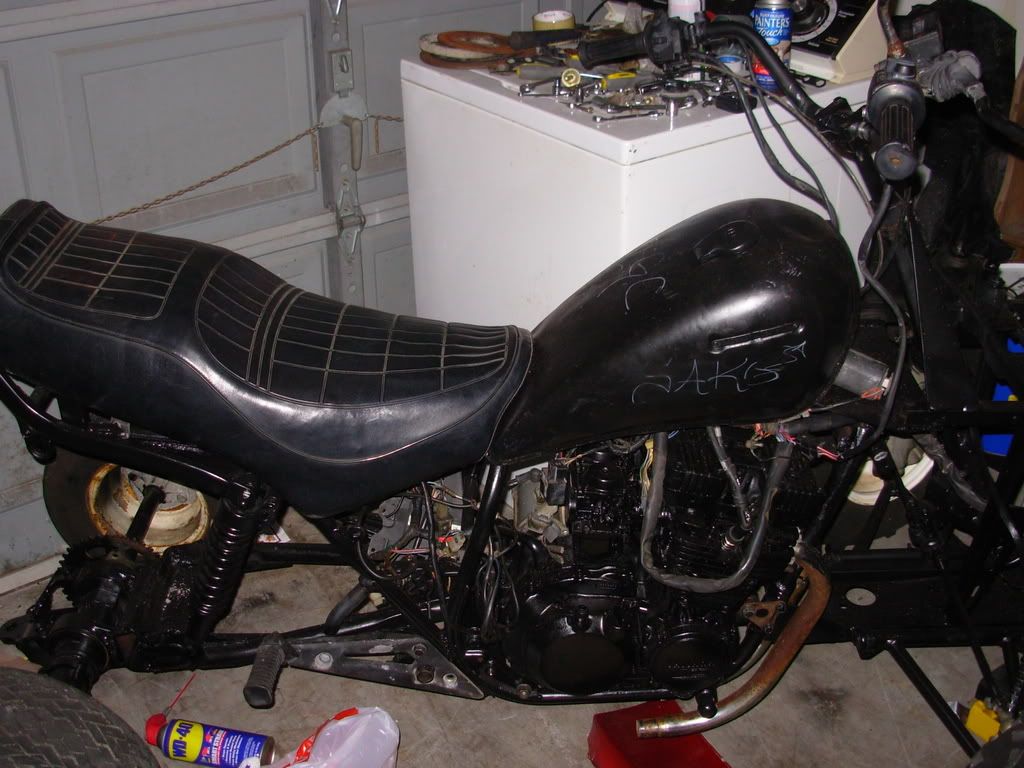

    i want to just run headers, will this decrease performance of motor? does it sound like crap when you get on the throttle?

    It will be WAY loud and will make the engine run very lean. Lean means it will run like crap and have reduced performance.

    "zoomies" will run like crap until mid-top rpm, assuming your jetting is good. down low it will sound like poopy in my opinion.
    straight pipes into one 2 1/4 or 2 1/2" pipe would make it a little better, and help the scavenging a little more. 2 1/4 pipe would bring the usable power in a little sooner on the rpm range.

    can anyone point me in the right direction for either 4 into 1 or 2 into 1 exzaust? i just baught the down headers for the motor, so i just need to either modify it, or just buy from the collector to the muffler. i do still have the origional collector and exzaust from maxim. can i use that?,,, wont my 2 back tires be in the way?

    Loolagigi- - Fitting the stock collector sounds like the easiest fix for now, then add 2 shorty stubby glass packs and you're done.
    And we're all dying for pic 's!
    As for the gearing, if you have a short enough rear tire, like seen on racing 4 wheelers, then you're not so far off. Tell us the tire height.
    Another problem is cooling- - when the street engine is going 45 MPH, you are at light throttle. Plenty of cooling air. The ATV at 45 is pulling more weight with high drag tires. On dirt it's full throttle, hard brakes, full throttle non-stop until you're out of gas. Dirt bikes have 2-3 inch fins, street bikes have 1 inch fins. Careful not to cook the motor.

    PICS NEXT WEEK FOR SURE. ..... i have a 9" rim with a 16" tall tire on the rear. they look like golf cart tires. not alot of tread.

    the gearing should be good, the quad tires are much smaller than the bikes was. it will be fast, but it has plenty of power for it!
    with higher flowing exhaust you will need to jet bigger as previously stated. it will be insanely loud with straight pipes, i rode my 750 with just a 4-1 header, and it had the voice of a formula caar with the volume of a top fuel dragster! and with that setup, and proper jetting it was sluggish until 6000rpms then it would RIP my arms out. kinda cool!
