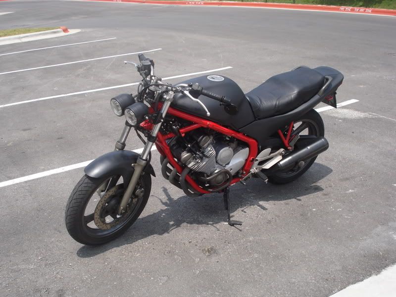

    Here is an example of a seca II street fighter. Note the extremely simple, "Bare legal" look. The starting bike was really broken, fairing-wise, to start with.
    Bear in mind, with a fully faired bike, you're going to have to do a lot of tucking and hiding of wires to get it to look remotely clean. That guy just yanked off his gauge cluster. Something with a small shield (the rage fairing perhaps) or new gauges (a digital all-in-one speedo would look awesome, I almost bought a custom CB750 street fighter with that setup) would be in order.

    Dat's simple but just looks like a fairly old bike now. Going for a one of a kind custom look. I like something that no other person likes or will do. Got to set myself apart from the pack. Thank you for the advice. What size motor would be an easy swap for my 600 if any.
