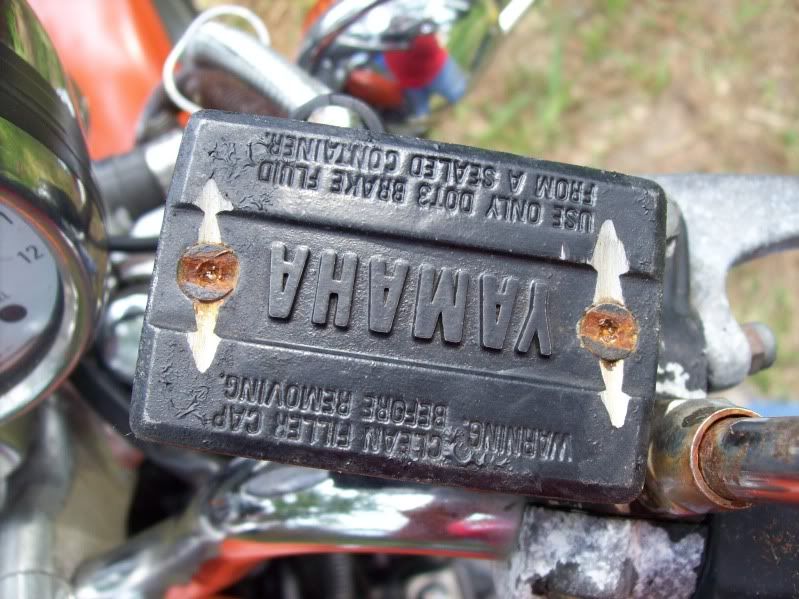

    So for my saturday festivities Iam trying to remove the screws on the top of the master cylender on my xj maxim they are rusted and striped what is the best course of action?

    Could you specify or give us a picture of witch screws.
    But generaly give it some heat, put the screwdriver in the screw give it a stroke with a hammer and try to get it of.

    been there done that. on the new seca i just bought i soaked those screws with liquid wrench with a squirt a day for 5 days. then find a good screwdriver that fits well. then i lightly tap on the head of the screwdriver while putting turn out pressure. go slow dont strip the screws. with practice you lean how aggressive you can get without brakeing anything. i do this same trick on engine cover scres also. if all else fails order some new screws first. then drill the head off and use vise grips and heat. your going to find more stuck screws than not on these old bikes.

    These are the srews

    The hammer trick worked! Man I have never seen brake fluid look like that should I just soak the resivor in brake cleaner. Yuck! I will completly drain all fluid and put new fluid in

    Nice job! I had the same problem and ended up drilling out the old screws and replacing them with some new ones from the hardware store

    Drill them right out and don't worry about leaving a fragment.
    You can Drill-off the Head
    Remove the cover and Diaphragm Gasket.
    Grind the Fragment.
    Center Punch the Fragment.
    Drill the Fragment right out.
    Tap the Hole and don't forget to enlarge the Hole on the Cover.
    Use a "Single Hole" Paper Punch or a Leather Belt Hole Cutter to cut a new pair of Holes in the Diaphragm Gasket.
    Tap New Threads.
    Use some Stainless Steel Cap Screws as New Fasteners.
