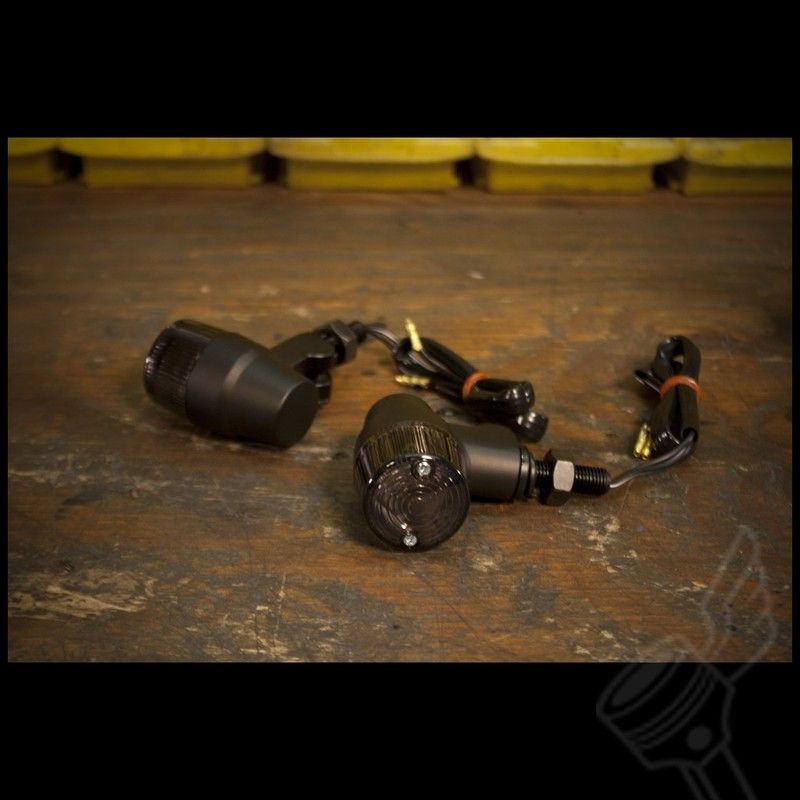

    My advice would be to avoid LED's and go real bulb. You can still get small slimline ones.
    I used these:
    http://www.dimecitycycles.com/vinta...ini-oval-turn-signals-blinkers-25-8350sm.html
    I like them because they are pretty dark lenses when not on but they flash like normal - at least they seam bright to me. Gives my bike the look I wanted with no colored plastic but has a nice bright orange flash when on. I think it help too that the lenses are dark because it's not an orange piece of plastic that getting brighter, it's a totally different color, almost an on/off effect so it's more noticeable especially in the daytime. So what-do-you-know, I did something that makes me safer for a change ;).
    You still most likely will need to replace the relay even without LED's depending on what level of resistance the bulbs give. I had to.

    I have the small round blinkers from dimecitycycles.com, I think they look decent. Not exactly cheap but they are pretty bright so ultimately I am happy with them.
    They also have smoked lenses of the same ones that I have...
