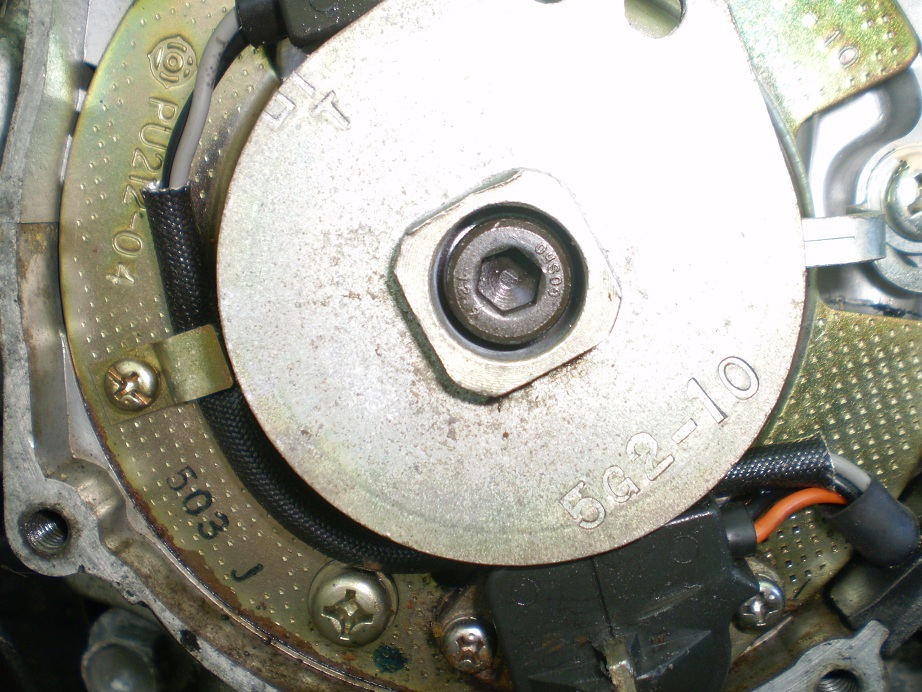

    The TCI IC Ignitor numbers should match the numbers that are stamped on the reluctor underneath the pickup coil cover...see attached photos

    fiveofakind...took th cover off and had a look at th reluctor..5G2-10, same as th TCI. Great bit of info' for th topic, don't recall seeing that before.

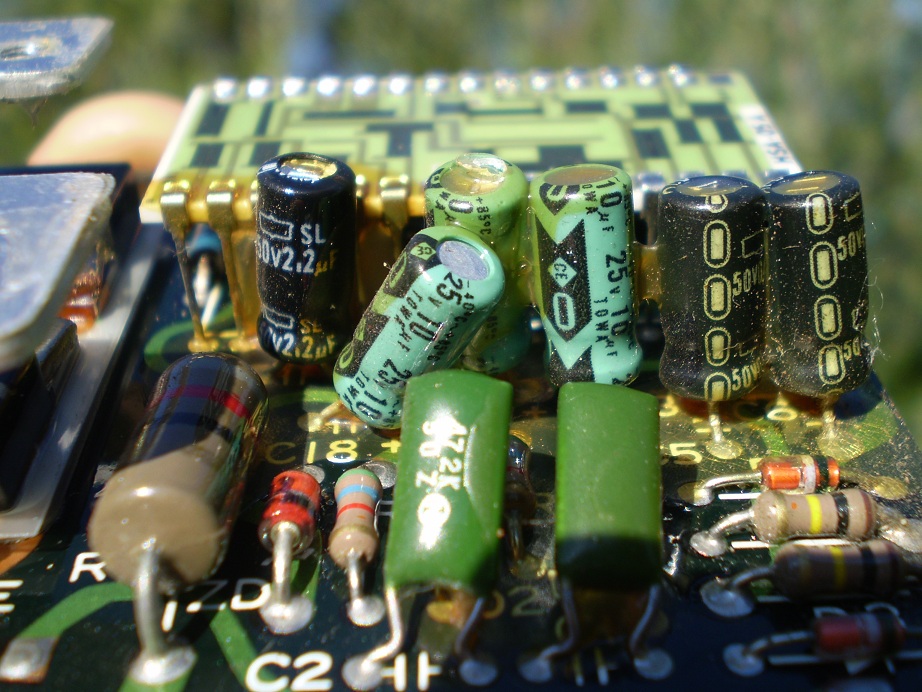

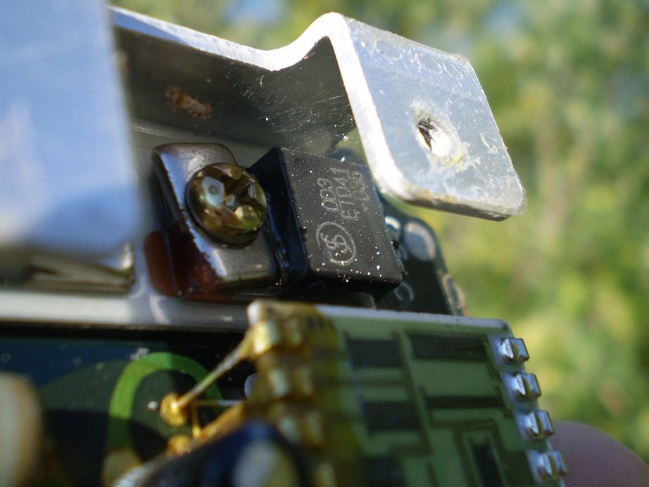

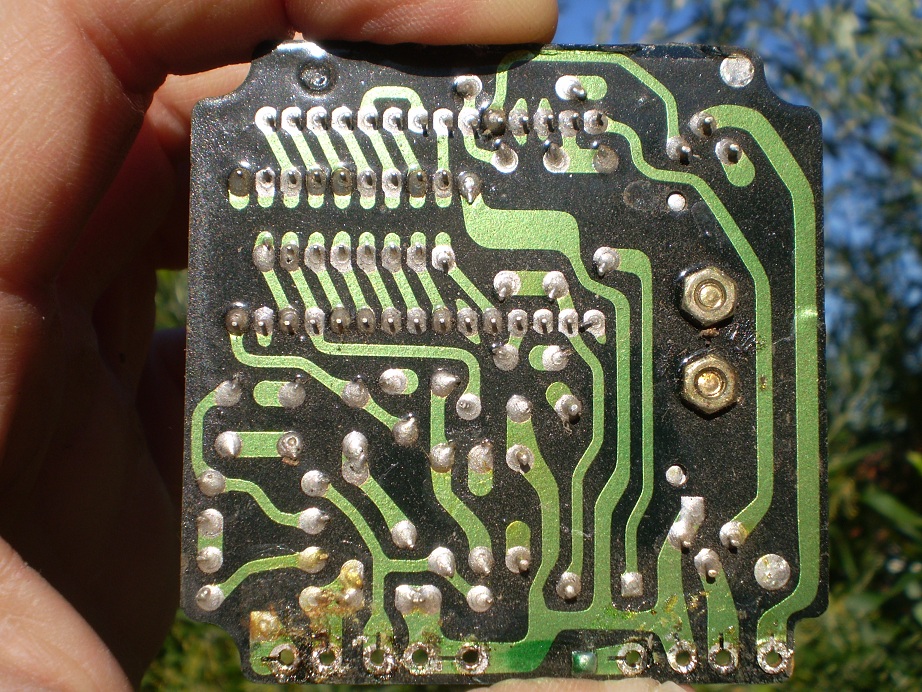

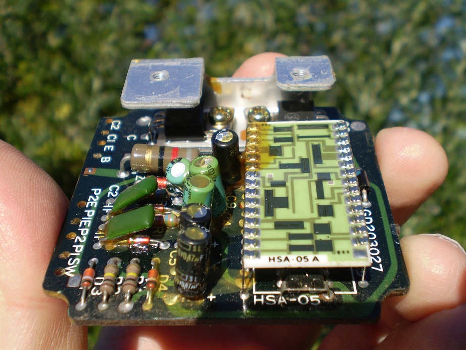

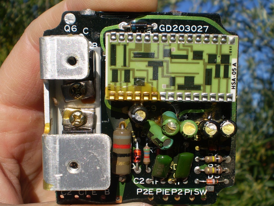

    Apologies for the mountain of pics, in advance...
    Here are some close up pics from the removed TCI board, hopefully Robert can do the magic ID!
    and that reluctor-TCI match tip is great... mine definitely do not match!

    Looks like the one from my 82 SECA 550.
    Of course, I can't tell if there are any differences in the laser trimmed hybrid sub-board, but I can verify that the rest of the circuit and board is identical.

    Seca 550! I was told it was from a 750 81 but.. Just a couple of questions.
    Does the sub-board number match HSA-005?
    and Is the number to the right of the power diode(just above the IC) match the GD203027 on mine?
    I just couldn't make it out with the reflection in your pic.

    I can confirm that the main PCB is identical, including all the visible components and the "GD203027" and "HSA-05" markings.
    However, I unfortunately do not have a pic showing the other side (the normally visible side) of the sub-board, so I cannot confirm the existence of the "HSA-05A" on the sub-board itself, but my strong suspicion would be that it does in order to match the main board.
    One of the things on my long to-do list is to take the ignitor assy apart again, and when I do, I'll be sure to take some pics of the other side.

    I've seen this TCI layout on 82-83 750 Secas and Maxims.
    The HSA-05A board shows up on them as well as my 400 TCI. If it runs, be happy! And change the capacitors at your convenience.
    CDS1984, I've shamelessly grabbed your photos for inclusion in my library of TCI photos. I hope you don't mind.

    On the white ceramic sub-board, you see the black rectangles? That is resistive material that is silk screened onto the ceramic substrate and then cured. Notice how they always span at least two of the silver traces? In circuit, they are resistors.
    Now if you look carefully at some of the resistors, you can see a line that starts at one end and proceeds from there towards and often past the middle of the resistor. That line is a burn mark from a laser which is used to cut through the resistive material leaving a thinner, and hence, higher value resistor.
    They measure the resistance as they burn away the resistive material and stop when the resistance is where they need it to be.
    Obviously, you can go up, but you cannot come down.

    The comment I made earlier was an observation I noticed......
    That the TCI Ignitor number stamping & the plate & reluctor underneath the pickup coil cover match.......does that hold true for all of these bikes ???
    That the numbers should match, then one knows whether they have the correct TCI Ignitor matched for their bike ???
