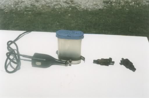

    trying this out, I bought a small sonic cleaner today and was surfing to find the best cleaning liquid. Didn't find that answer but ran across an interesting approach to making your own sonic cleaner.
    This innovative guy wanted to clean his auto fuel injectors so clamped an electric engraver (vibration source) tightly to a Tupperware container. Swore it works great. Same principle might also apply to a larger (carb sized) container and some sort of larger vibration engine (I dunno what).

    I can see it doing better then nothing but it won't be as good a purpose built unit.

    I'm sure you're right about that. Personally know nothing about it other than what I saw on web forum, but interesting. Builder says he leaves parts in for 30 minutes (longer than cleaning times I've heard on many production sonic cleaners).
    Still... intriguing idea if I can think of a stronger vibration source. Gotta be firmly fixed to the cleaning drum (or somehow immersed?). Maybe Don will have another of his awesome invento-genius brainstorms about this someday. :)
