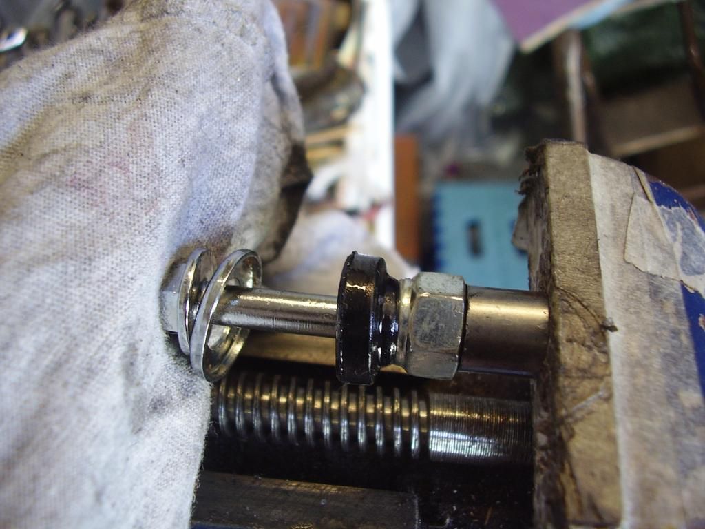

    A few drips of oil from an emptied oil bottle work just as well. I just push them together by hand.
    Warm them up with a hot air gun, Dab of oil, push, done.

    that's a good tip from "hog", I buggered one new seal up, using my homemade set up.
    luckily one of the old seals was still good, so reused it

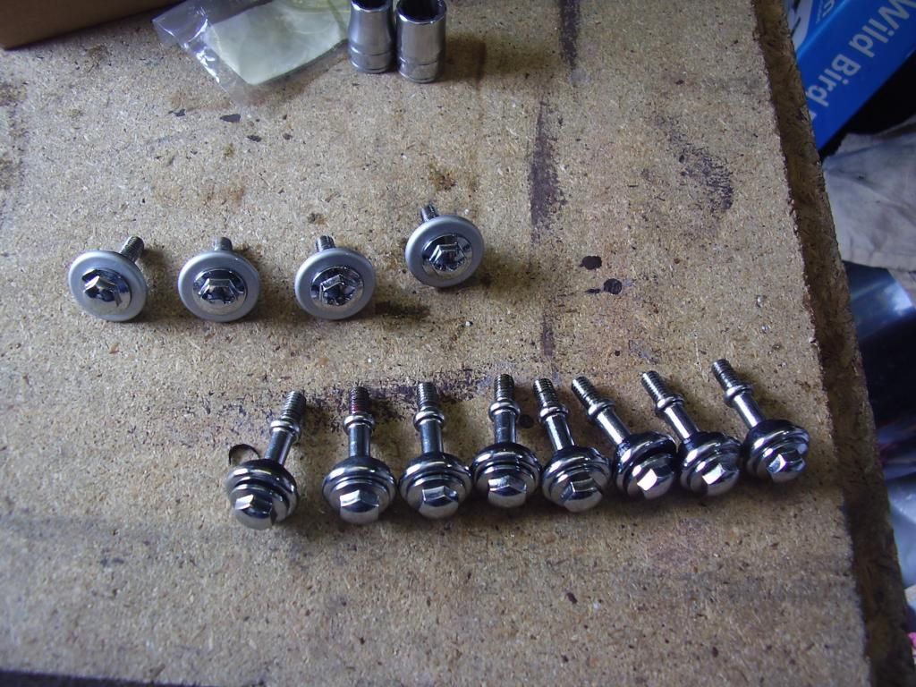

    It looks like the four middle bolt seals are larger than the other 8. Advice is appreciated.
    yes that's right ,as above

    No, the outside 8 are smaller.

    hmmm, I like the look of those chrome bolts and doughnut caps. Were those stock on your bike? Mine has flat headed hex bolts.
    the bolts and washers are stock, but they're originally black. I had the bolts and washers chrome plated, before I put new do'nuts on.
    the 4 larger washers I sprayed with the silver engine paint
