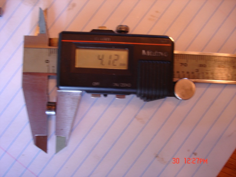

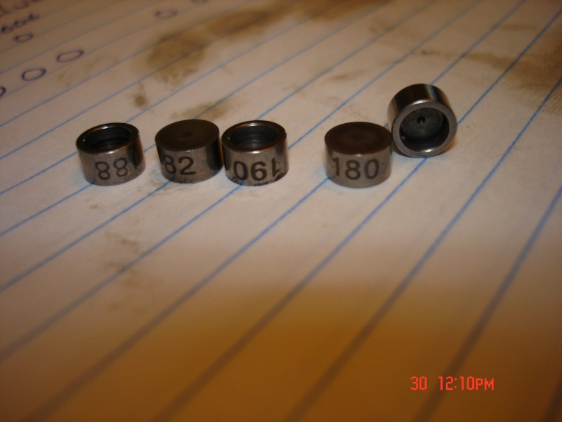

    Just for information is the shims for the Maxim-x (From my previous FZ750) are like the following image ?
    If so why the pad 190 measurement is 4.12 is not suppose to be 1.90 mm ???
