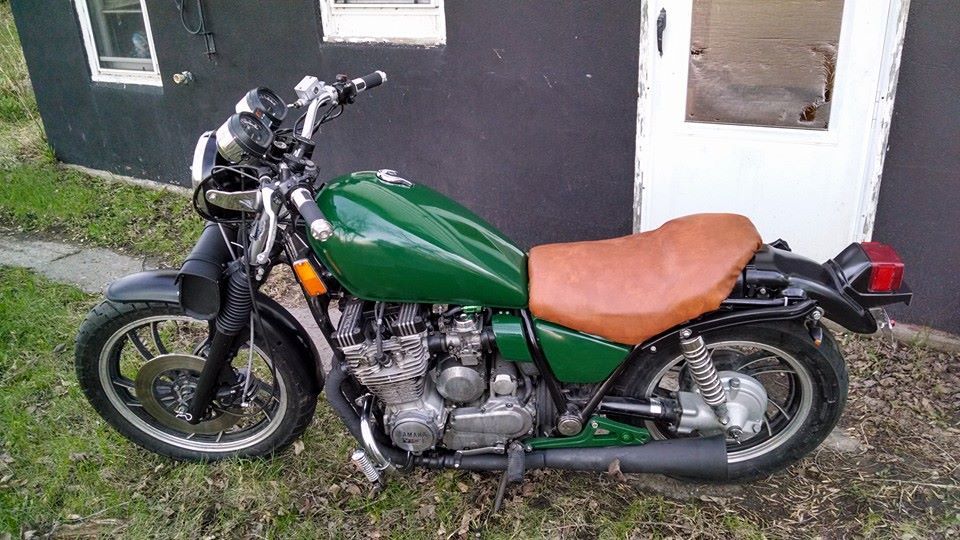

  6. Hotcakesman
    Hotcakesman Active Member
    387
    South Dakota
    I just shaved mine down and then bought some vinyl off Amazon
    then just restapled it to the seat with a power stapler
    this is the original seat just shaved and recovered
  7. Shanesajda
    Shanesajda Member
    167
    southbury ct
    Looks good @Hotcakesman I Think Im going to try to do the same but go even smaller with the seat. You used the same bottom? Or a new base to staple to?
  8. Hotcakesman
    387
    South Dakota
    same bottom
    you can make is more slender
    I then drilled a hole and put a bolt into it
    and then drilled a hole in the fender so that then I used a washer and
    nut of the underside of the fender to fasten it
    much less of a headache, and no need for any fabrication
    also keeps airbox in tact
    I would advise adding a gel pad into the seat, I did not
    and shaved it down and covered it with Yoga mat (3 layers)
    but after an hour of riding you feel it
    this winter I am going to add a 60 dollar pad, then re-upholster
