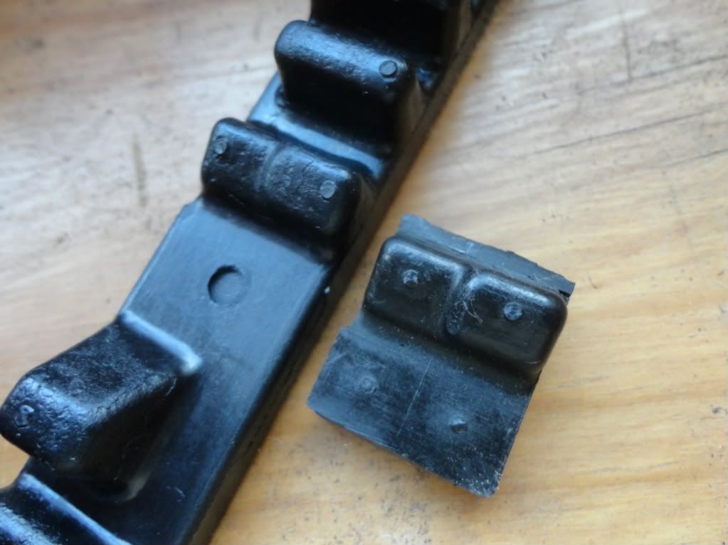

  12. pillowmaster50
    pillowmaster50 Member
    105
    Ya. Chain guide. Here's a piece of my broken one, and the replacement about to go in (courtesy chacal (Len)).
  13. ThomasTX
    ThomasTX Member
    Beautiful, Crime-Free Grapevine, Texas
    Oh yeah - That's what it is! I guess it's better that I found out now, not after I put some shiny new clutch parts in it and rode it for a while.
