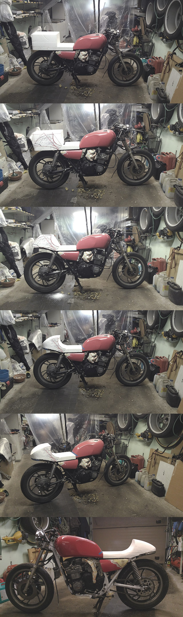

    I'm still fine-tuning the shapes of my seat, but here's a couple of steps shown :

    And, to add I did try the flower-arrangement-foam, the green/brown stuff that dime city cycles uses in there how to youtube video.
    It was really really easy to shape BUT it was at the same time really porous and swallowed a huge amount of glue and broke really easily.
    I got some high density foam from a buddy of mine that build boats in carbon fiber, they use it to make plugs for molds, so I thought that it would work for my job to. Plus side on the high density foam is that it won't collapse if you want to put under vacuum later when laminating.

    Your foam seat looks really good so far, get 'er fiberglassed now!
