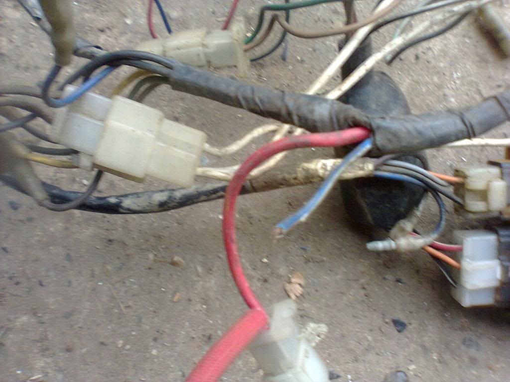

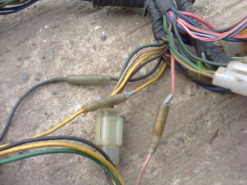

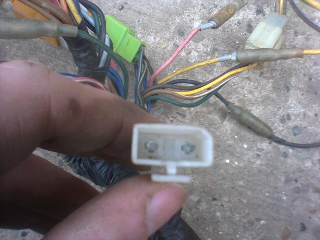

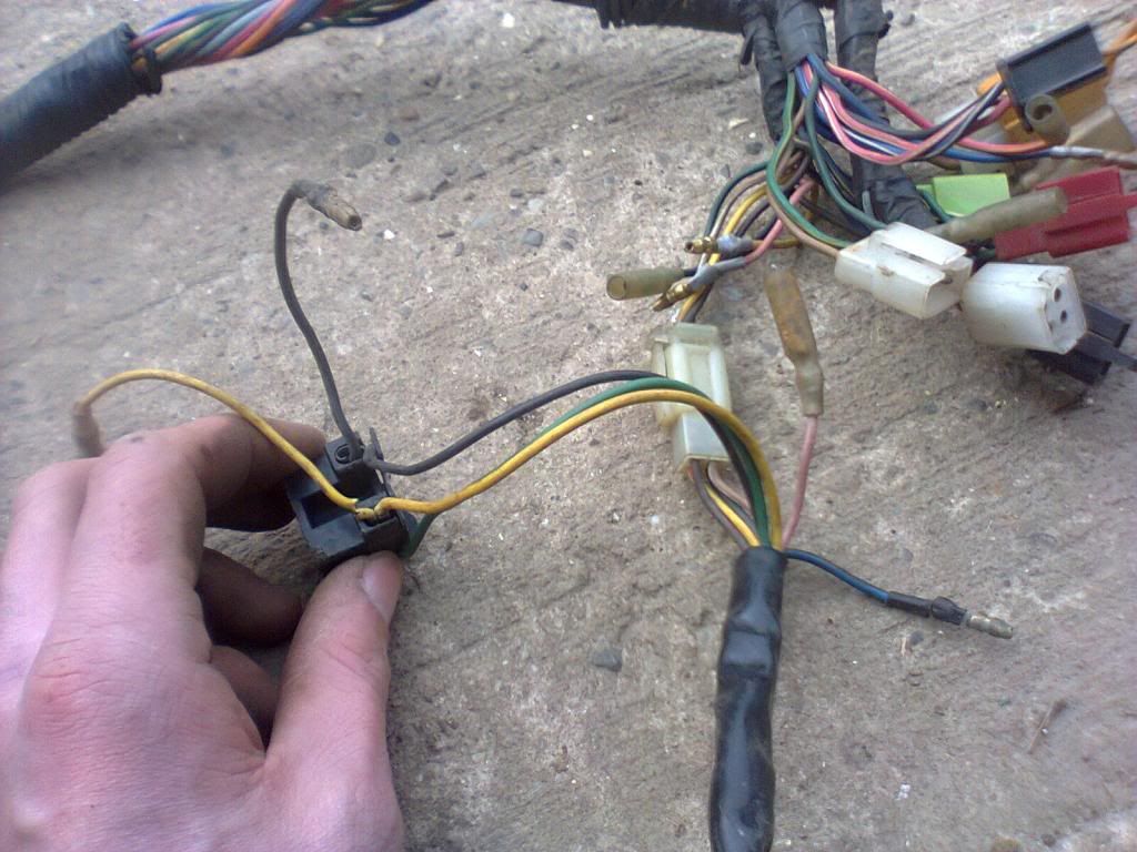

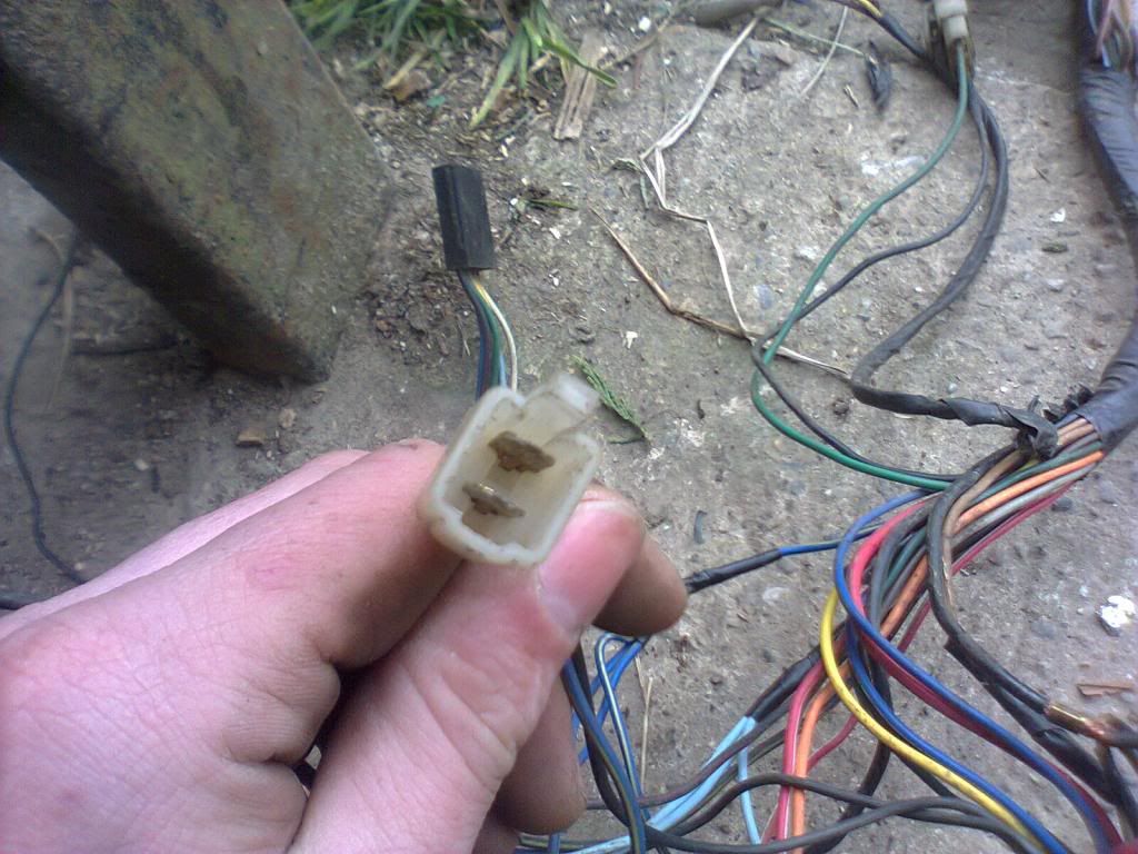

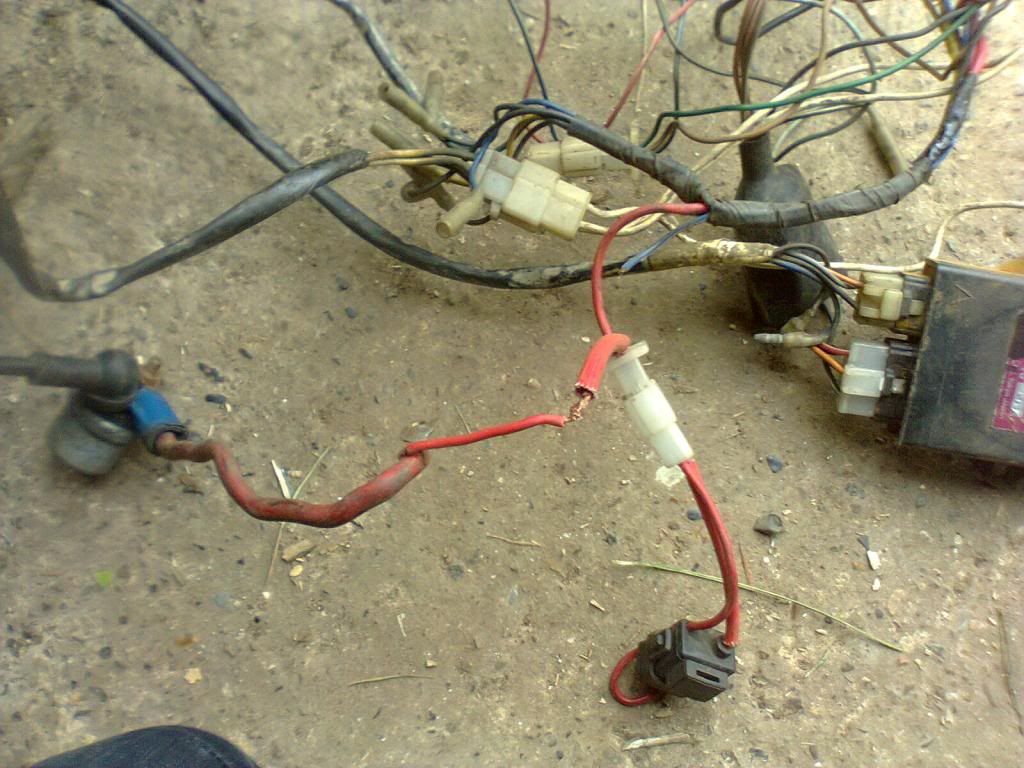

  15. maximtrike
    maximtrike New Member
    ireland
    photos

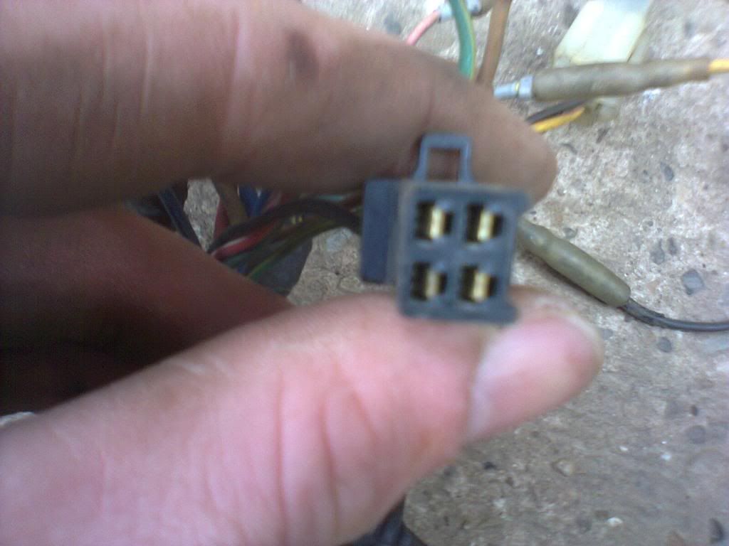

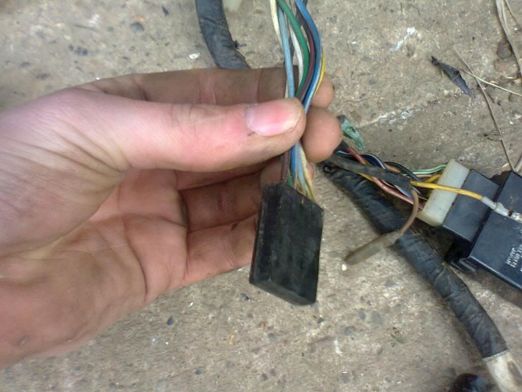

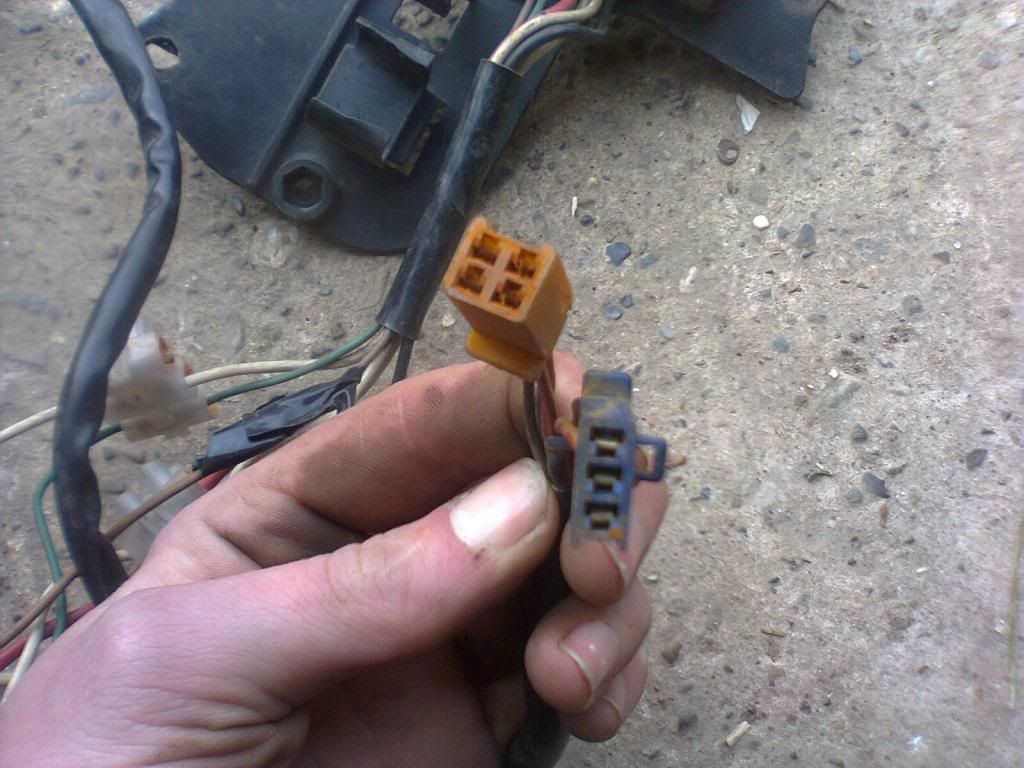

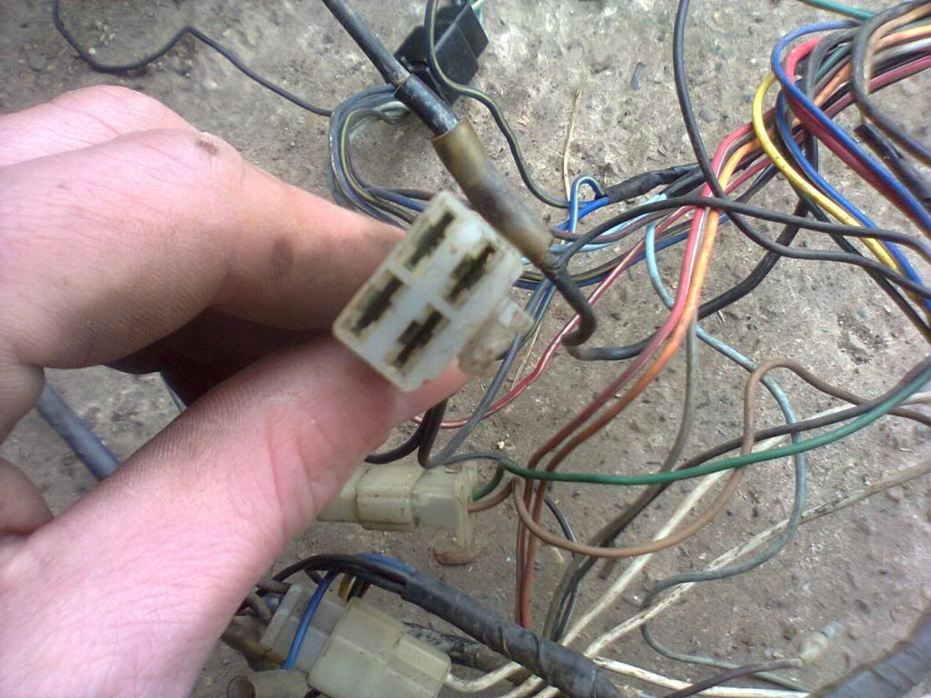

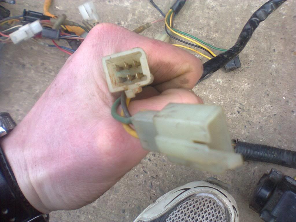

    have updated this with pics of where im stuck on the loom all description of wires is in the comment underneath pictures thanks
  16. 750E-II_29Rbloke
    1,955
    South Cheshire, UK
    Righty ho then... Just added the pics as photobucket's being slow today & also everyone can see them now :) I'll go through the post editing in any comments shortly so check back over it & I'll add them in blue text... I'll do my best & invite anyone else to get involved too, but TBH the loom looks pretty hacked up & it may be worth getting another better loom that you know what spec it is & know the colours are right... Is there a sticker anywhere on the loom with a chassis number or model code on it?
    but I see a yellow there too. Could do with lining things up flat with the wires spread out untangled a bit if possible... what colours does it plug into on the loom? It does look like a diode pack :?
    This one sounds like a US 750 max but some wire colours don't fit my diagrams, pic of the 6 pin's wires please?
    Can't find any connector with that combo in my diagrams
    Likely to be front brake light switch
    US (Maxim) left switchgear, diagrams weren't great here but would say the bullet connectors go together if they seem to "fit" how the wiring would be routed if fitted to the bike
    My diagrams don't show a black/white going to the regulator :? they do have a white wire from the reg/rec to the diode plug though so maybe that's an error in the diagrams?
    Likely to be sidestand switch[​IMG]
    May not be XJ, none of my diagrams show that plug combo. What are the wire colours?

  18. maximtrike
    ireland
    ok so in the post about the spare connector with a black and white going to reg/rec? i meant to say it is going back to the tci! and on the diode i have included a new pic and i left out the yellow wire before, the only code on the loom was 1FG-not 100% on the 1FG but 99% (the writing is a bit faded) ive included new comments anyway to explain ab it better for ya to check out please... thanks
