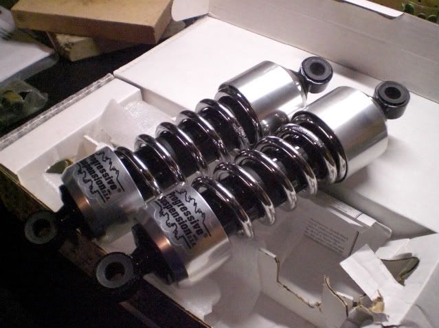

    Got myself a little something for Xmas and after a couple of shipping delays, they're finally here!
    Progressive 440 Series shocks. Mmmmm... Chock full of bouncy goodness! 11", eye-to-eye with a nice a heavy spring rate and a price that didn't make me cringe! Now I just have to wait til it's warm enough to actually work on the bike so I can mount 'em...

    Yup. They are purty...
    As for why to change them, the shocks on our bikes are ~25yrs old. Sure they don't see the mileage that a car of that age does but that's still a lot of years on 'em and they take their toll. Besides, even out of the box, the original shocks were nothing to write home about.
    Of course, in my case I wanted to go with something a little shorter than stock. I rode last summer with some Suzuki Savage shocks (10.5") and I loved them. Lower centre of gravity made the bike feel really planted and stable and it improved the handling. My only complaint with those ones was that they would bottom out occasionally. Actually, the shocks didn't bottom out but I'd get some tire rub on the inner fender. That's why I went with the Progressives. Slightly longer, less travel and heavier spring rate.

  11. bigfitz52
    Because the KYB units the bikes came with weren't very good even when brand new. Further, they didn't last more than about 6000 miles before they went from just being crap to being worn out crap.
    I used Progressive Suspension 12-series with chrome springs on the '81 and black springs on the '83. The "vanity caps" on the 12-series are plastic so those went bye-bye; they LOOK stock but perform oh so much better. The rear turn signal comparison shot in my gallery shows both sets very clearly.

    They arrived today. I think I choose the wrong color. The blue is almost a purple like color. Looked more blue online. Oh well, I might have to paint the springs. I had to use my rubber bushings. The Frame has 14mm studs. They are 1/4 inch shorter dispite adjusting but what a difference! I rode it down a long brick street that i ride about every day. The bike is so much more stable now and I first noticed the change stopping. No longer does it rock when the front fork spring becomes unloaded. I can't include picture. See gallery.
