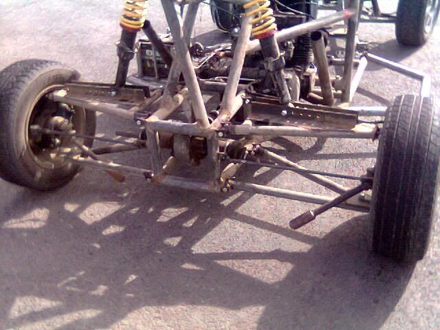

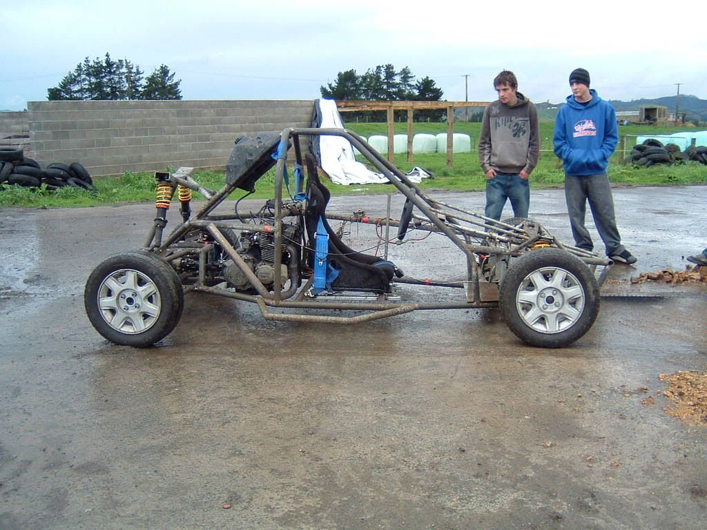

    Heres some old pics of our offroader in case you're interested...
    XJ650 too powerful for my halfshafts :D

    That looks like a lot of fun. I'm now working as an Audio Engineer so I got to see and hear this at work, that is one very loud buggy. How deaf is the driver going to be?
