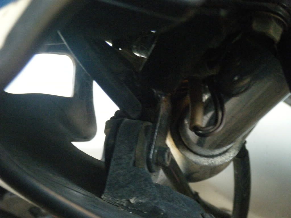

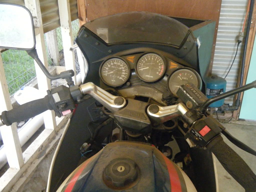

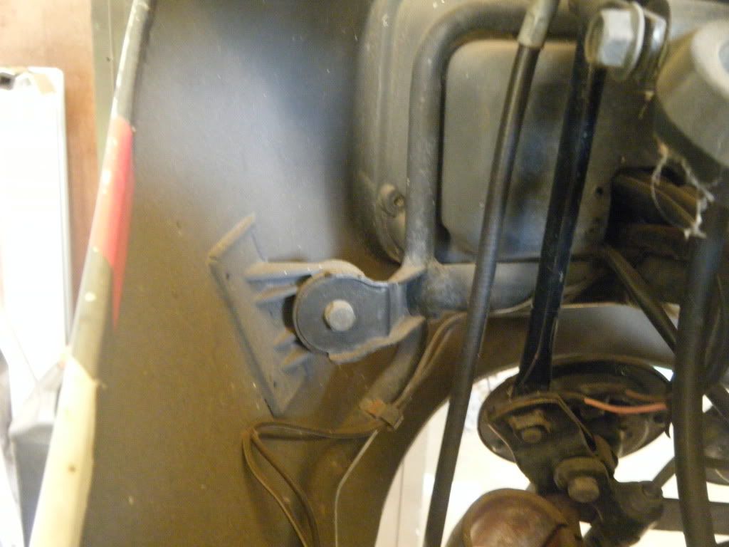

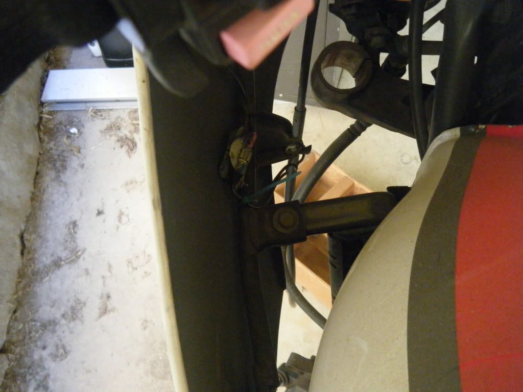

  7. gunnabuild1
    gunnabuild1 Member
    607
    I hope this is what your after,they are not disassembled but if there is something in particular you want just ask.
    Handlebar mounted 900

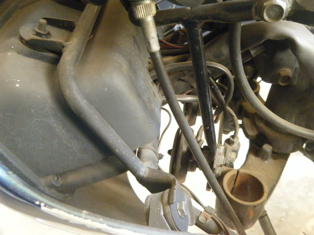

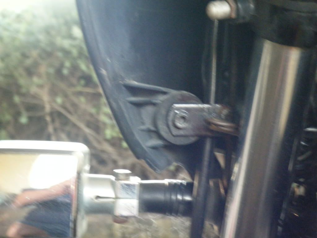

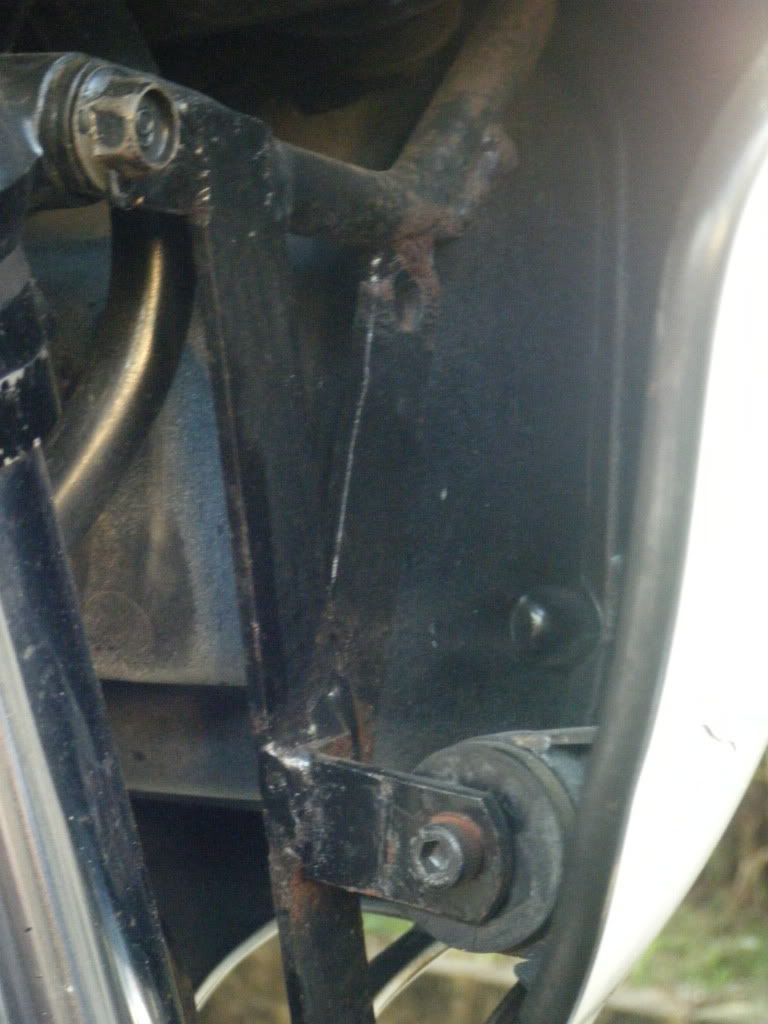

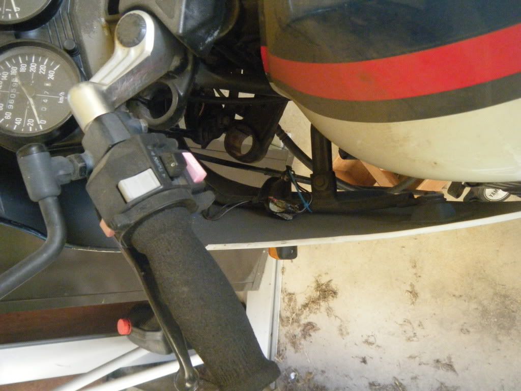

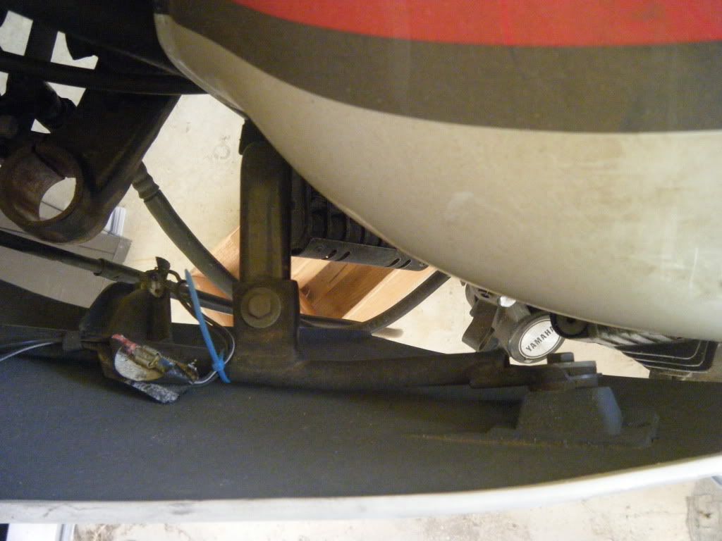

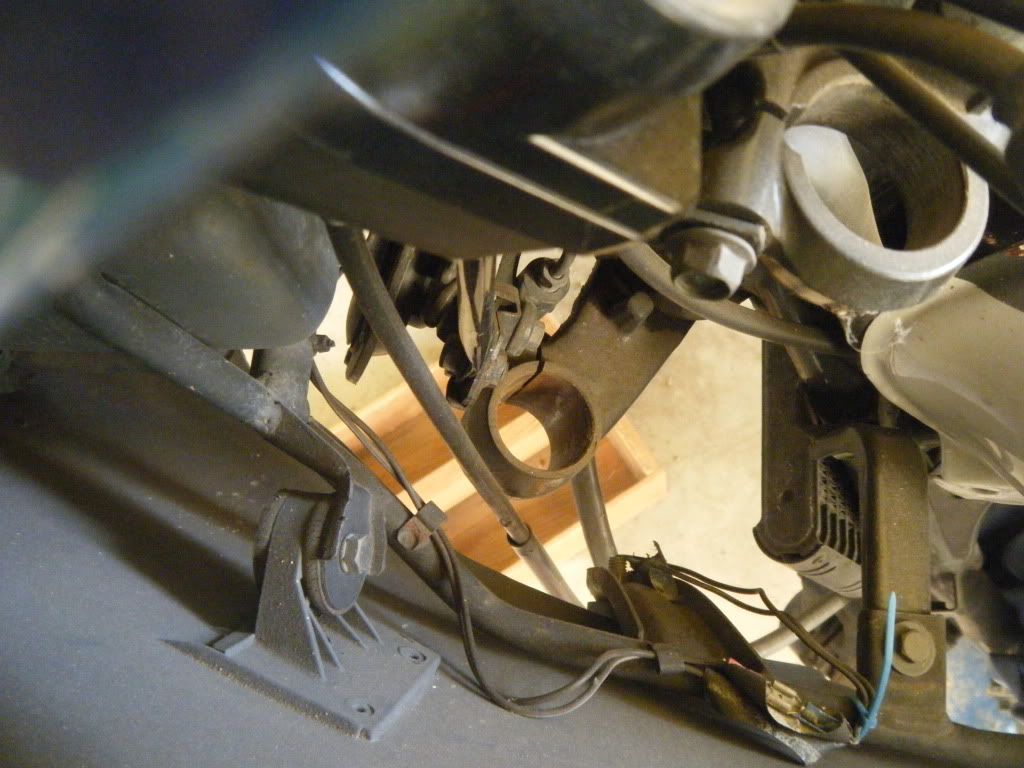

  8. gunnabuild1
    gunnabuild1 Member
    607
    Frame Mounted
    I hope this is of some help.

    gunnabuild1:
    Thanx for the pics. It helps answer a few questions.
    In order to attach the frame mount fairng on a bike that originally came with the fork mount bikini fairing. A Mounting flange would have to be fabricated, and welded onto the steering neck tube. As can be seen in the last pic on the right side between the two bolt heads.
